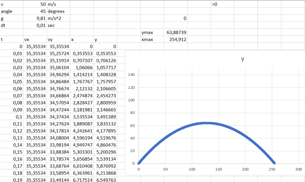

I have a few questions that I wanted to ask you guys regarding the method by which we implement the Runge-Kutta approximation of Projectile Motion if we should do it using a numerical iterative method with a Spreadsheet like Excel.
I have already constructed a simulation in Excel using the Euler method basic physics formulas and implemented both gravity, drag and wind forces. Now I wish to improve upon the accuracy by using a better approximation of the X,Y coordinates over time with RK4.
Here's how I constructed the spread sheet with The Euler numerical method (using gravity, but ignoring drag and wind):

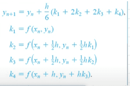

and I suppose these are the formulas that should use to get the improved approximation with the Runge Kutta Method:
To clarify, I am trying to get a list X, Y coordinates as function of time, using a set of initial conditions. The initial values should be able to be freely changed to get approximations of any type of movement along the x-y plane.
I hope my phrasing & terminology is sufficient. This is mostly a DIY project, not homework or school related.

I thought it may have been clear from OP, but it may have been too broad. I'm trying to get an understanding of how to relate a set of initial conditions to the evolution of motion, using the RK4 method, in a similar fashion to what you would do with the Euler-Cromer method.
That is, I have an object a x,y position thrusted in any direction with a specified velocity. Using Euler's method I use the simple iteration of x= vx*dt+x, y=vx*dt+y formula.
How can I use the RK4 to solve the exact same problem? I recon I need to calculate the value of the function "f" ? How does one go about it?
My goal is to then compare the two solutions to see how much they diverge over time when I plug in different initial values.

Unfortunately the video skips a couple of steps in relation to my question and I have looked at other videos that also seem not to mention how I get the function of the ODE from a set of initial conditions.
In this video he uses f=3X^2Y. If I need to go from the information(Example); Starting point (0,0) velocity = 75/ms at (35) degree angle and translate this info into a function, what would be the appropriate steps then?

Have you seen this?
No, that particular site escaped my search and it does in fact provide some very useful info. Thanks.
Only problem is that it deals with RK2, not 4. Hopefully I will be able to deduce the logic behind it and modify it to suit a forth order approximation instead.
