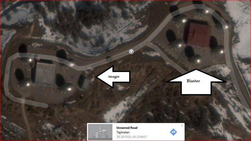

Well I'm sure no expert just a curious amateur.
Tom Clancy fascinates me and sometimes i check him against Jane's just out of curiosity.
I just finished "Cardinal of the Kremlin" . When i checked Google Maps , Clancy's Russian 'satellite killer lasers' were exactly where he described them in 1988 .
I know, it's a thirty year old book .. i really enjoyed it.
Likes Delta Force and berkeman
