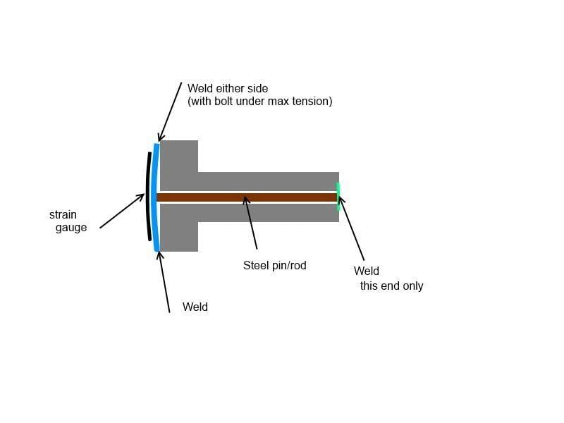

Had another another idea. See diagram.
Suppose you drilled a hole right through the length of the bolt and put a wire pin through it. Then weld the tip of the wire to the bolt at the thread end only. When the bolt is tensioned/released the pin should move out/in of the head end very slightly. If a thin (spring?) steel strip was fixed across the head as shown the pin should bend it slightly and perhaps that could be measured with a regular strain gauge.
The bolt would need to be put under maximum tension when the pin is cut/ground down to length and when the steel strip is fixed to the head. When the tension is released the pin would deflect the steel strip. Increasing strain on the bolt would reduce strain in the steel strip.
I think this approach might even compensate for temperature effects.
I suppose you might even get away without the steel strip, just fix the strain gauge to the head with silicon sealer or something similarly flexible?
I like this idea - clever thinking :)
