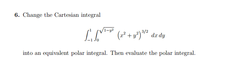

my only problem curently is in finding the angle θ. I do get the equation x^2 + y^2 =1 however am confused whether this would be a semi-circle on the positive axis or a full circle. because my teacher has notes that confuse me. for instance ∫[itex]\sqrt{1-y^2}[/itex] -[itex]\sqrt{1-y^2}[/itex] my formatting is a bit off but that would be higher/lower bound. that is the only case where she made a complete circle, instead of a semi circle.
if it is a semi circle, theta would be 0≤ θ ≤ PI/2
however if its a full circle, since from y=-1 to y=1 it would be -PI/2 ≤ θ≤ PI/2.
x goes from 0 to the positive square root of ##1-y^2##. What part of the circle do you get when you solve it for ##x## and take the positive root? That will tell you which ##\theta##'s to use.
i think it would be the right hemisphere of the circle, since x=0 and increases, and the circle has radius of 1. so -PI/2 ≤ θ ≤ PI/2 what i got is right?
Yes.
OK. then i got r3 by looking at f(x,y) so I ended up integrating ∫(r4 dr)dθ and got my final answer as PI/5.
Integrating with r from 0 to 1, [itex]\theta[/itex] from [itex]-\pi/2[/itex] to [itex]\pi/2[/itex].
Yes, that is correct.
