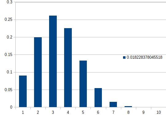

The probability of getting a sample mean equal to the population mean may be zero. For example, consider the mean of a binomial distribution with parameters N = 10 and p = .33. When the mean is most probable value, it still may not be very probable.
The mean is 3.3 and the variance is 2.2. The probability of observing the mean, in this case the closest value to the mean is .26, hardly close to zero. The probability of finding the value of the mean in the range of mean ± σ is .81 pretty high and where you would expect to find the mean.
But for a Poisson approximation to be valid for a binomial distribution p << 1 and the mean should be much smaller than the maximum number of events.
"The closest value to the mean" is not the population mean. The probability of observing exactly 3.3 is zero. That's my point. It's in reply to what you wrote:
The mean being the most probable value is the one most likely to appear in any measurement.
If you're going to change your argument so it discusses the probability of values within 1 sigma of the mean, then it needs to be revised.
