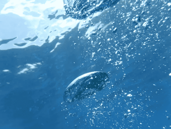

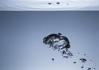

And to add either confusion or illumination to the mix:
Air bubbles are only spherical when they are small enough that surface tension can force then into that shape.
Larger bubbles have a flat(ish) floor.
This may make it easier to see how the water is attempting to flow downward around and under the bubble.
