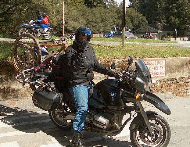

here are some fotos of my current rack sistemthis is how it looks when I'm really load it.

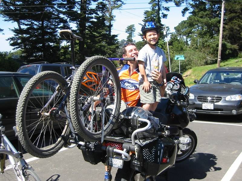

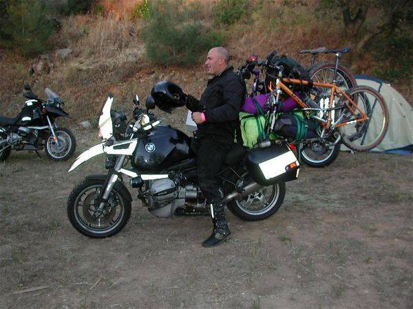

I can carry a passanger and their bike, in fact i travel from california to utah,colorado, British columbia and mejico more than ones with my girlfriend(s) and her bike.

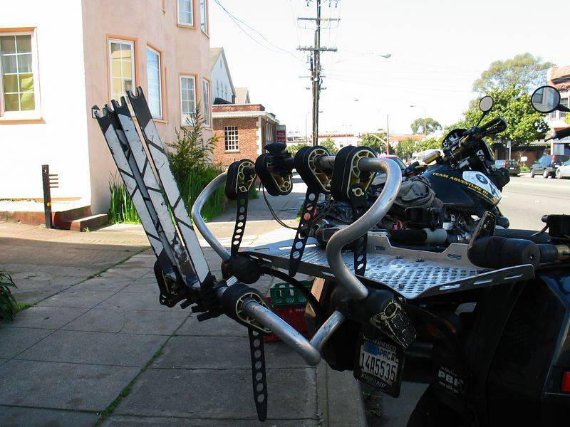

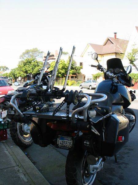

I construct the sistem base on a "Palmtree" concept, a.k.a. Nothing in it is rigid and the bikes arem "Encorage" to move around (rock side to side) that way none of the loads from the bicycle gets transmited into the motorcycle, in fact the ride is quite pleasent and unevenful do to this feature.
but to make it that way, i was force to find materials and shapes that will flex without generating to many stress riser points and focal loads that can generate cracks or failures.
Well,,, bicycle parts pretty much do it al the time, so the question now was were to find some "Donor" parts => no big deal if you work on a bicycle shop so I found some "Useless" parts and "when to town"
I have no idea who this kid is, but i manage to provide Him with some smiles and a nice experince and that is all it counts in my book.
