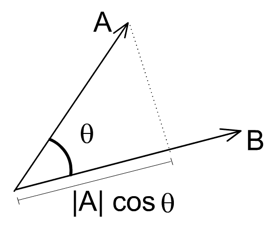

The Dot Product *Review*
Above is a graphical representation of the dot product.
The dot product is a scalar product of two vectors and is denoted as:
\vec{P} \cdot \vec{Q} = ||\vec{P}||_{2} ||\vec{Q}||_2 cos( \theta)
In component form:
\vec{P} \cdot \vec{Q} = P_x Q_x + P_y Q_y + P_z Q_z
In matrix form:
\vec{P} \cdot \vec{Q} =[ P_x P_y P_z] \left[\begin{array}{c}Q_x\\Q_y\\Q_z\end{array}\right]
Important Points From this Review
  • Any vector dotted with itself is the magnitude of said vector
  • Any vector dotted with an orthogonal vector is zero
  • The Matlab command for the dot product is >>V=dot(P,Q)

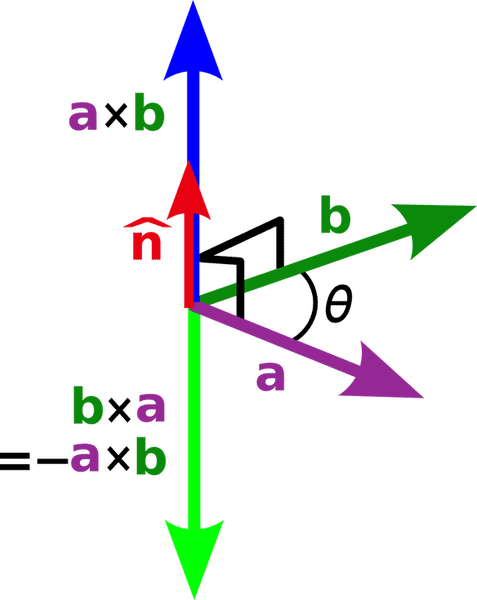

The Cross Product *Review*
Above is a graphical representation of the cross product.
The cross product is a vector product of two vectors defined as:
\vec{V}=\vec{P} \times \vec{Q}
or:
||\vec{V}||_2=\vec{P} \times \vec{Q}
or:
\vec{V}=\vec{P} \times \vec{Q} = det \left|\begin{array}{ccc}\vec{i}&\vec{j}&\vec{k}\\P_x&P_y&P_z\\Q_x&Q_y&Q_z\end{array}\right|
In matrix form:
\left\{\begin{array}{c}V_x\\V_y\\V_z\end{array}\right\} = [\tilde{P}]\{Q\} = \left[\begin{array}{ccc}0&-P_z&P_y\\P_z&0&-P_x\\-P_y&P_x&0\end{array}\right] \left\{\begin{array}{c}Q_x\\Q_y\\Q_z \end{array}\right\}
Important points from this review:
  • The vector produced is orthogonal to both vectors P & Q
  • The cross product is not commutative
  • The Matlab code for the cross product of two vectors is: >>V=cross(P,Q)
