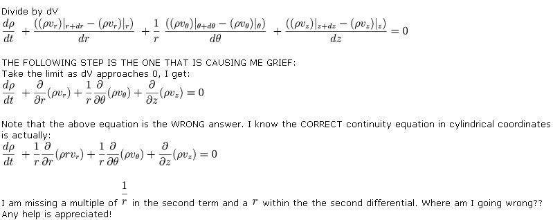

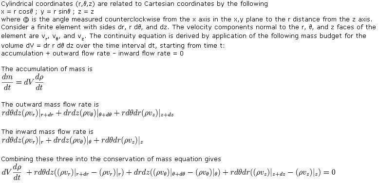

Help! I am stuck on the following derivation:
Use the conservation of mass to derive the corresponding continuity equation in cylindrical coordinates.
Please take a look at my work in the following attachments. Thanks! =)

I think it's in the first attachment where you chose to evaluate only [itex]\rho v_r[/tex] between r and r+dr and not the entire term. You forgot here to include the r, which comes down to taking into account the changing radial velocity but not the change in surface area the fluid flows through.[/itex]
da_willem,
Thank you thank you thank you! After picking over my work for about a week now, I can't believe I oversaw this rudimentary step!
Your help is greatly appreciated! =)
No problem, glad to be of help.

in the outward mass flow rate expression posted above, the r-plane surface area expands moving outwards, so the 1st term should be (r+dr) dtheta dz (rho vr)...etc.
fix that, then combine flow rates and divide by dV = dr dz dtheta and you're A for away
just want to be sure, should it be like this below?
[tex]dV\frac{d\rho}{dt}=dV\frac{\partial\rho}{\partial t}+d\theta dz{[r \rho u_{r}]}\right|^{r+}_{r-}+dr dz{[\rho u_{\theta}]\right|^{\theta +}_{\theta -}}+rd\theta dr {[\rho u_{z}]\right|^{z+}_{z-}}[/tex]
