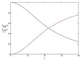

I'd love to have such a map for my vehicle, but I can't find it. Modelling the optimal acceleration rate for a vehicle is fraught with complexity, the engine map would nail down one variable among many.
  • #35
The drag at low speeds is very small.
