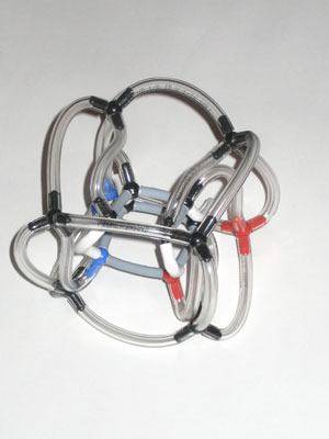

The Mark I
My first attempt is with chemistry building blocks. The vertices are all carbon atoms.
I didn't work out because the lengths of the sides have to change. The "struts" that join the inner and outer cubic tables are shorter. But this model doesn't do that; the structure doesn't collapse properly; it won't easily turn inside out.

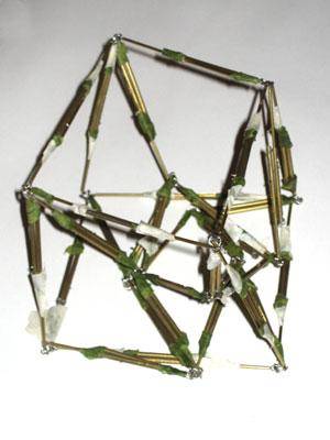

The Mark II
This one is built with great pains (trust me on this) to make contractable/expandable struts like pistons (32 struts, each made of two pistons for a total of 64).
This had a very interesting lesson: when we allow the device to do what it needs to do to rotate, it now does it too easily. All 32 struts must change length at the same time. This model would not hold its shape long enough to even get it looking like a tesseract, it just collapsed like so many sticks in a game of pickup sticks. I couldn't even set it up to take the pic!
You can see the outer cube, the the inner one just falls flat.
I need a model that is self-supporting.

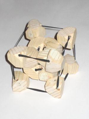

The Mark III
My next attempt, which I've just finished, is made of even more permanent material, and more exacting measurements and its solid structures provide some support so that it does not completely collapse in on itself.
The basic subunit is a cube with four corners truncated and a joint in the face of each. (The cubes, all 16 of them, with their 4 truncated vertices apiece, have been cut and sanded to within less than 1mm) The subunit cubes are joined by stretchy elastic cord.
Interestingly, while a a cube has three edges to every vertex, a hypercube has 4 edges to every vertex. One side-effect of this is that every subunit has an even number of cords attached to it. That means no subunit has an end of the cord, the yare all "pass-through". That entire elastic cord is one single piece, threaded through out the entire model. In fact, it has zero ends - it's a loop.
That aside though, I'm still having some troubles. It still doesn't easily transform from one shape to another. Too much friction and too much loosey-goosey.
I have yet to create one that smoothly transofmrs from one shape into the next without a tremendous amount of awkward, show-stopping fiddling.
Also, I have not yet managed to get the thing to open a portal to an alternate dimension, making me rich and famous beyond my wildest dreams of avarice.
I continue on my quest.
I would have suggested hollow, low-friction, telescoping rods with an internal, low-stiffness spring.
That is how the Mark II is built.
The low-friction thing was what I worked very carefully on. That was the rationale for the hours of precision work. Strangely, it turned out to be the wrong thing. Those pistons have zero frction. So little that I can't even get the thing to stay put; I basically have to support every single strut at all times or it collapses into what you see. (And I don't mean standing on its own, I mean when I'm supporting it in my hands, I can only hold a dozen or so struts. Any that I'm not holding just flop like an old woman's funbags.) That's what all that tape is on there for in the pic above; it's there to add friction.
As for the spring, that's pretty tricky. Sometimes it needs to have compression tension, soemtimes it needs expansion tension. That was the rationale ofr the Mark III. The solid shape provides an automatic spacer - two forces in opposite directions (so that the spring can always be compression.)
I was thinking that the spring would be good because it has a natural length that it'll want to retain. That would prevent the kind of collapse that happened with MkII. Also, some friction is good, as a damping force. Ideally, you'd want the system to be optimally damped.
