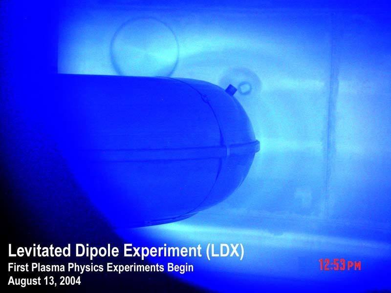

I watched the video, which was very interesting. This reactor is definitely on a smaller scale than ITER. I was surprised when they said that the 'donut' part of the reactor levitates during fusion. I wonder if ITER will do the same thing?
No - the designs look similar but are different.
In a tokamak (ITER) the magnets are on the outside and the plasma forms a ring inside the chamber.
The MIT design is almost exactly the opposite - the magnet is in a ring inside and the plasma forms a donut shape around the magnet. The levitating part is simply to avoid having any mechanical supports to the magnet which would interfere with the plasma.

It seems to me that there are some serious flaws with this 'internal' magnet design, namely the the floating doughnut in any realistic reactor would quickly be destroyed by the high energy products of fusion. A great deal of work has been put towards the outer walls of tokamaks: exotics for the first wall, backed up with molten lithium to carry away the heat, etc. None of this seems possible w/ a levitated internal super conductor. Am I missing something?
I'm not an expert but I think that precisely one of the advantages of the floating design.
In a tokakmak it's very difficult to hold large amounts of plasma with different energies in a tight ring.
With the floating design the plasma is both held away from the ring by the field (self focussed?). The outer vacuum cryostat can be as large as you like since it isn't part of the field, so can be kept away from the plasma.
I thought extracting the energy normally requires deliberately allowing some plasma to heat the walls which you can then use to generate steam.
Yes well I grant the idea that the floating dipole might do well at plasma confinement, that is the stated purpose. But that has little to do with the high E neutrons with which a working design must be concerned. The plasma, i.e, charged nuclei and electrons, is never intended to come into contact with anything solid. In D-D or D-T fusion, the neutrons, contained by nothing other than collisions, carry almost all of the energy produced in kinetic form at MeV levels into the walls of the reactor. That is where energy is absorbed in the form of heat by the ITER design. The neutrons also a have the side effect of making the containment vessel inevitably radioactive as Lidsky pointed out (above) while slowly destroying the first wall. (I believe ITER researchers say walls can be built that would last a year in a working reactor). I'm speculating that since the MIT dipole can not be made so tough, nor can it carry away heat, that it would be destroyed no so slowly. :rolleyes:
Good point, I didn't think of the neutrons.
A magnet quench would be interesting in the floating design as well!

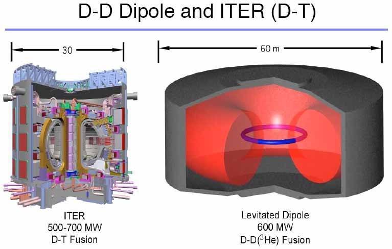

Unfortunately, none of the MIT-LDX links work. However, the temperatures (> 16000 K) would be incorrect. The highest melting points would be 3890, 3880 and 3800 K for HfC, TaC and carbon, respectively, and C's boiling point is 4300 K! I believe that the temperature should be more like 1600 K.
Ref - http://www.ultramet.com/ceramic_protective_coatings.html
Carnot cycle efficiency
According to reference 1 pg. 22, the surface input temperature is 1641 K and the internal temperature of the high temperature superconductor is 50 K, the refrigerator shell would occupy the differential radial difference.
Applying this to the Second Law of Thermodynamics for the fundamental limit on refrigeration energy and specifically to Carnot's theorem for Carnot cycle efficiency, the equation becomes:
[tex]T_C = 50 \; \text{K}[/tex]
[tex]T_H = 1641 \; \text{K}[/tex]
[tex]\eta_{th} \le 1 - \frac{T_C}{T_H} = 1 - \frac{50 \; \text{K}}{1641 \; \text{K}} = 0.969531 = 96.9531 \; \%[/tex]
[tex]\boxed{\eta_{th} \le 96.9531 \; \%}[/tex]
Current household refrigerators energy efficiency:
[tex]\eta_{th} \le 50 \; \%[/tex]
No known refrigerator exists that can sustain the required MIT-LDX refrigeration energy efficiency. Therefore at its limit, such a reactor design could only operate in a pulsed mode.
Also, according to reference 1 pg. 16, the diameter of an industrial MIT-LDX type reactor design would have a diameter twice that of ITER. (see attachment)
d_iter = 30 m
d_ldx = 60 m
Reference:
http://psfcwww2.psfc.mit.edu/ldx/pubs/presents/DPP03_kes.pdf"
