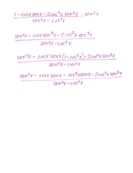

Thank you for the prompt input. I did make a mistake trying that way. I took your advice and started on the right hand side. Here is where I am at.
On the end of your first page, you canceled the sin2x from the numerator, but not from the denominator?
[tex]\frac{(\frac{1-cosxsinx-2cos^2xsin^2x}{sin^2x})}{(\frac{sin^2x-cos^2x}{sin^2x})} \neq \frac{1-cosxsinx-2cos^2xsin^2x}{(\frac{sin^2x-cos^2x}{sin^2x})}[/tex]

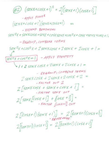

I have still not solved the trig Identity. I gave up on it for the time being and completed two other ones. If anyone has a solution to the first posted identity. Please let me know! Here they are if anyone is interested:
