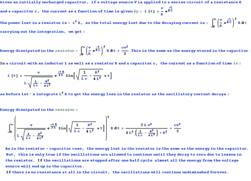

I've attached an analysis of the problem for the R-C and the R-L-C cases.
But, the fact that the energy that ends up in the capacitor in these two cases is only half the energy provided by the voltage source doesn't mean that every method of charging the capacitor loses half the energy from the source. I described two methods that don't suffer from that loss in a previous post.

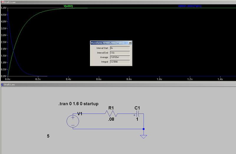

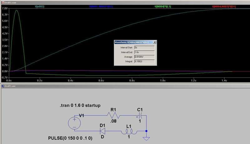

Yes if you are allowed to use an inductor and a switch it's easy to do.
Just get a voltage_source, an inductor, a switch and the capacitor all in series. Let the initial voltage on the capacitor be zero and the value of the voltage source be one half of the final voltage that you wish to charge the capacitor to.
Close the switch and then re-open it on the next zero crossing of the current waveform (at [itex]t = \pi \sqrt{LC}[/itex]). The capacitor will then be charged to twice the voltage source value, ideally without loss. This is the basis of how a resonant mode DC-DC converter operates.

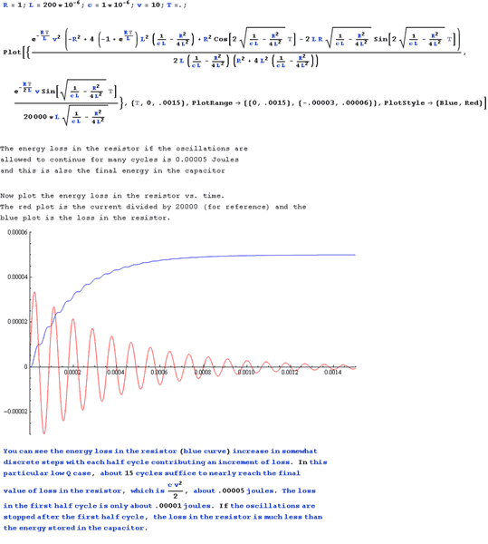

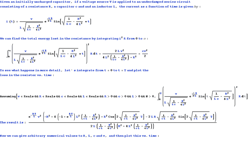

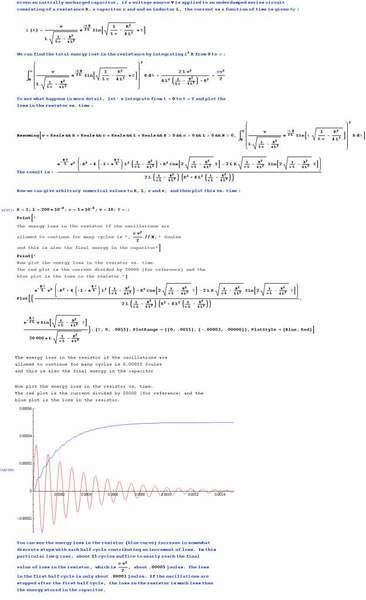

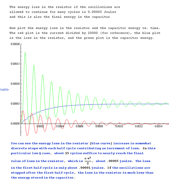

I've worked out the full-bore mathematical analysis of an underdamped RLC circuit, with a suddenly applied voltage step.
I've plotted the energy loss in the resistor vs. time. It can be plainly seen that if the oscillations are allowed to continue until they damp out, the loss in the resistor reaches a final value of c*v^2/2. But, it can also be seen that in the first half cycle, the loss is nowhere near this much, so that if a switch is opened to stop the oscillations (such as a diode) after one half cycle, the efficiency of charging the capacitor can be much higher than 50%.

I added a plot of the energy in the capacitor vs. time to the plot.
You can see that after many oscillations, the energy lost in the resistor equals the energy stored in the capacitor, but if the oscillations are stopped after one half cycle, the energy lost in the resistor is a small fraction of the energy in the cap.

Notice uart's expression for i is the same as my expression for i(t) shown in the first image of post #22, except I have taken into account resistance in the circuit. I think it is without question that the factor of 2 is wrong.
spaceball3000 said:
Thank Uart & Electrician for the followups, I'll passed your info, almost seems like he want's to give out misinformation.
You should be sure to show him the image I included in post #24. It really tells the whole story.
