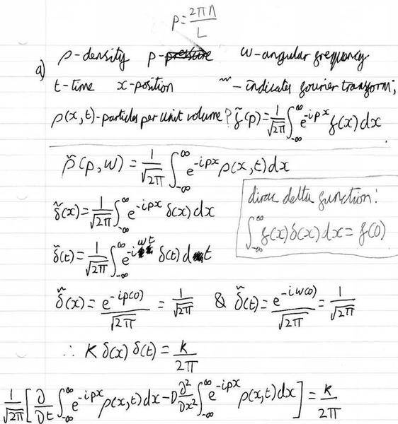

I'm really at a loss on this question, which is why i have achieved so little on it so far. I think i more or less understand what a Fourier transform does (transpose amplitude vs time to amplitude vs frequency, ie the Fourier transform of two combined sine waves would be two spikes in frequency space).

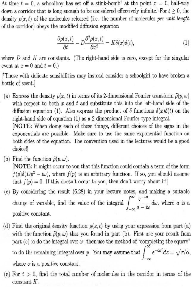

In part a) I'm not sure how to express the product of d functions d(x)d(t) as a Fourier type integral.
Any help appreciated.

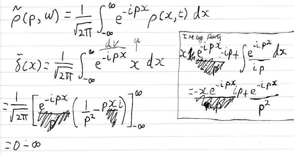

Well that is a lot of questions, but let me help you on what you have done so far. First off, in your first line you forgot to take the Fourier transform of the time variable, yet you have [tex] \omega[/tex] in your function on the left hand side.
Also, for the delta functions since the variables are separated you can take the Fourier transform of each delta function individually. You tried to find the Fourier transform of [tex]\delta(x)[/tex], but forgot to include the delta function in the integral. For some reason you wrote it as x in the integral and not [tex]\delta(x)[/tex] which is very easy to integrate.
Ok I've had another go at this problem today, although i haven't really got any further than last time;
I thought i had taken the Fourier transform of the time variable, as it is included in [tex]\rho[/tex](x,t)?

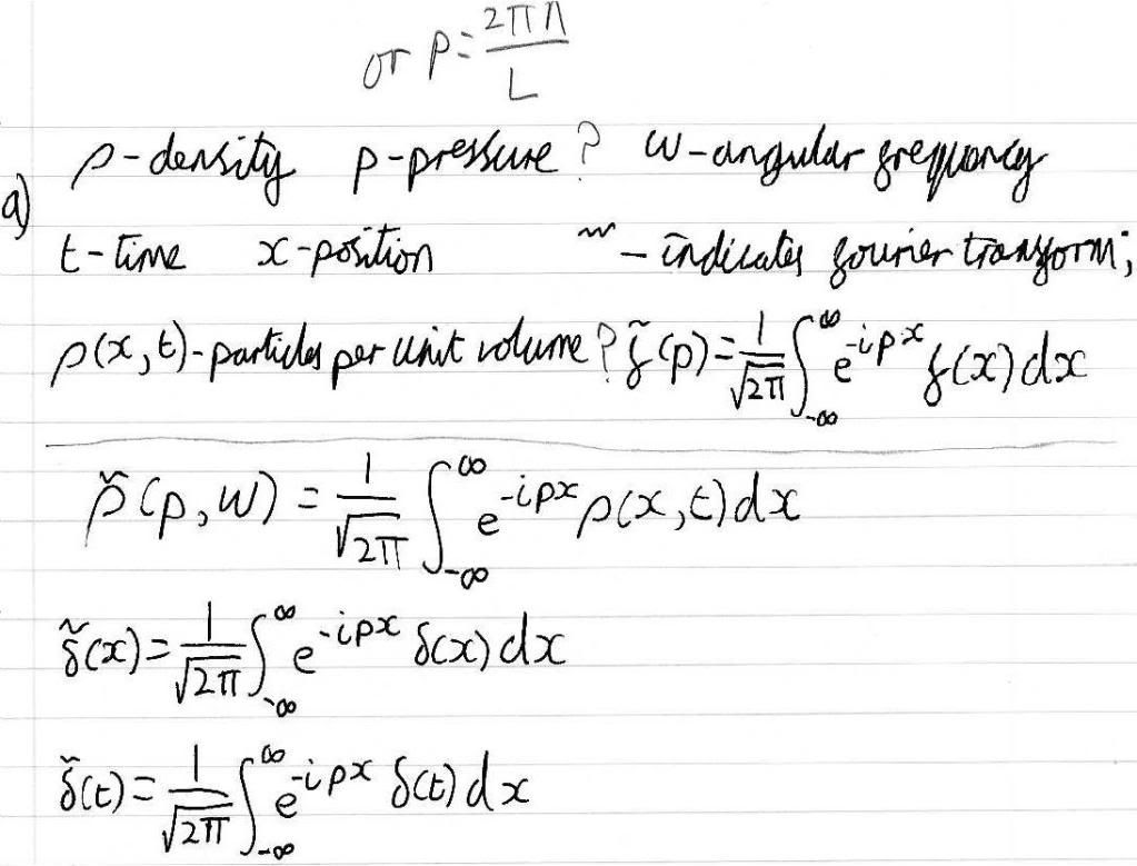

I am unsure what p (not rho) is supposed to represent in the question, at first i thought it was pressure due to the question being about diffusion in a gas, but after reading through my notes thoroughly it mentions p=(2[tex]\pi[/tex]n)/L, and [tex]\delta[/tex]p=(2[tex]\pi[/tex])/L when deriving the Fourier transform from the Fourier series. I don't see how that makes sense in this question though as L is infinite (as it has to be for the function to have a Fourier transform) which would mean p=0?
I'm not sure if i can take the integration any further than i have as their aren't given functions for [tex]\rho[/tex](x,t), [tex]\delta[/tex](x) or [tex]\delta[/tex](t).
Can i just sub the Fourier transforms as i have them now straight into the diffusion equation?
Well I am used to seeing 'k' and not 'p'. 'k' is the wavenumber, k = 2*Pi/wavelength. So 'k' has units L-1.
Also you have set up the integrals for the dirac-delta functions, now you can solve them. They are very easy to solve. Although your last equation is incorrect... You should have 'omega' and 't' and not 'p' and 'x'.

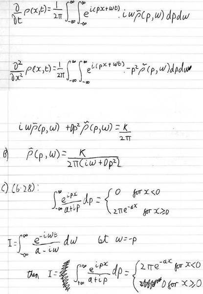

Alright I've made a little more progress, I may have finished part a) but I'm not sure:confused:
I think replacing all the functions in the diffusion equation with their Fourier transforms means i effectively have the Fourier transform of the diffusion equation? I don't think i can cancel down the Fourier transform of [tex]\rho[/tex](x,t) at this point, which means i get a long equation when substituted into the diffusion equation.

Well you got the transforms of the delta functions, but your final equation is incorrect. The first term should be:
[tex]\frac{\partial}{\partial t} \rho (x,t) = \frac{1}{2\pi} \frac{\partial}{\partial t} \int \int e^{+i(px+\omega t)} \tilde{\rho}(p,\omega) dp d\omega [/tex]
So you can take the time derivative inside the integrals and get...
[tex] \frac{1}{2\pi} \int \int e^{+i(px+\omega t)} \cdot i\omega \tilde{\rho}(p,\omega) dp d\omega[/tex]
Therefore the Fourier transform of the time derivative becomes:
[tex]\frac{\partial}{\partial t} \rho (x,t) \rightarrow i\omega \tilde{\rho}(p,\omega)[/tex]
You can do the same for the 2nd term in your equation. Once you have done that, you can easily solve for [tex]\tilde{\rho}(p,\omega)[/tex] doing some algebra.
Ok i have taken the double differential for the position term now as well, in your last post you seem to suggest that once i have taken the differential i can forget about the integrals and exponential term, why is this?
Had a go at a bit more of the question, my answers still feel dodgy though.
In (A), what is the object in front of the p^2? It should be a negative sign, but you seem to have a circle there. As for removing the integrals, well if you had done it to every term in your equation, then you'd have the exact same definite integrals everywhere. And they would cancel out, but too lazy to show it in detail.

It's supposed to be a D (crappy handwriting), I've substituted each term back into the original equation given in the question, which is where the D comes from. The negative term i got for double position differential cancels with the negative term in the original equation i think.
Alright then, I forgot about the -D in the original equation. So it looks good now.

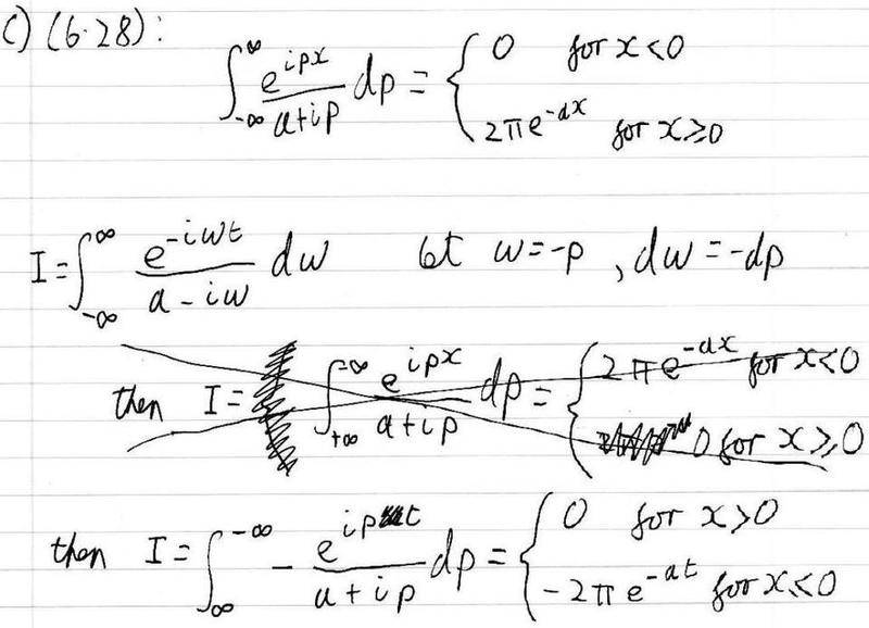

As for (C), when you substituted w=-p, you forgot to substitute dw = -dp. Also, you are not using 'x' in that equation, you are using 't'.
Ok i get this for part c) now:

(D) is just asking for rho(x,t). So do the inverse Fourier transform of rho(p,omega) that you solved for in (B).
