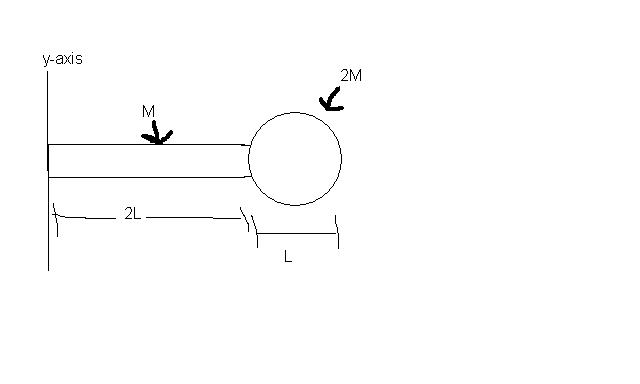

What is the moment of inertia about the y-axis for the system as shown. The stick has a length of 2L and a mass of M. The solid sphere has a diameter of L and a mass of 2M.
I=[tex]\int[/tex]r2dm
[tex]\lambda=\frac{m}{l}[/tex]
Should I have to integrals for this one? one for the stick and one for the sphere? Please help.
No need to do any integration, just use standard formulas for the moment of inertia of a stick and a sphere. Hint: Parallel axis theorem.

What does your teacher want? Do they want you to solve this using integration? This would take a bit of time for these two bodies. Or have you already been given the moment of inertia of a rod and a sphere and all you really need is the parallel axis theorem?
I guess what I am asking is this an assignment meant for practicing integration using the ideas of linear density and such, or just merely to find the moment of inertia for these bodies?
