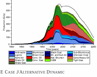

Steve Mohr of Australia's Newcastle University has modeled the Earth's fossil fuel reserves and come up with this massive study (warning: 13mb).
PROJECTION OF WORLD FOSSIL FUEL PRODUCTION WITH SUPPLY AND DEMAND INTERACTIONS
http://ogma.newcastle.edu.au:8080/vital/access/services/Download/uon:6530/SOURCE4?view=true
Plenty of gems in the study, like current energy consumption being the equivalent of every person on Earth having 90 slaves.
But headlines are that best guess for a production peak in fossil fuel is 2016–18 (at a total production rate of 509–525 EJ/y).
For the fossil fuels individually:
Coal - 2019 (212–214 EJ/y).
Oil - 2011-12 (179–188 EJ/y).
Natural gas - 2019-2062 (143-157 EJ/y).
Unconventional oil and gas will probably create a shoulder to the production curves, which will slow the fall-off the other side of their peaks, but will not change the peak dates themselves.
The most optimistic scenario for oil (p136 - case 2 dynamic) does see a second oil production peak circa 2110 that about matches the conventional oil peak. However this would have to be all shale oil (tar sands would be gone by then).
It is a little surprising that coal has so little time left (as China and India seemed to be rather relying on coal) and that gas will be such a big player in the final wash-up. On the other hand, it is what Mohr's group have learned about Chinese coal consumption which is accelerating that peak.
On the optimistic side, Mohr notes, it sure puts a concrete limit on the carbon footprint issue :smile:.

More like 100 years for oil (out to 2110) if we believe Mohr's case 3. Mohr has similar numbers for natural gas case 3. And in any worst case scenario, fossil fuels do not entirely collapse in seven years.
Oh boy, I remember the 'pessimistic' estimates in 1995 still being 2050, and that was near then. The pessimists are always more realistic it seems.
I also read the other day that IPv4 is expected to be saturated in 2010, that's also quite near.
Is this a rational summary of his findings?
Again, making the energy/economy link, we are really saying that unless we can find some other energy source, world GDP will peak in 2017 and smoothly decline for ever after. And this transition point looms in seven years on middle-ground assumptions.
The actual range of his worst and best case scenarios for peak fossil fuels is suprisingly narrow - 2012 to 2029.
Fossil fuel productions for CASE 1, CASE 2 and CASE 3 is projected to peak between 2012 and 2029 at 433 – 581 EJ/y.

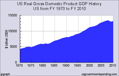

apeiron said:
...Again, making the energy/economy link, we are really saying that unless we can find some other energy source, world GDP will peak in 2017 and smoothly decline for ever after. And this transition point looms in seven years on middle-ground assumptions.
We? At least in the US, energy consumption per capita peaked back in the late seventies yet GDP has managed to increase substantially (per the World Bank):
http://www.google.com/publicdata?ds...l=en&hl=en&q=us+energy+consumption+per+capita
It may be that energy production and GDP is more closely correlated in developing countries like China, which strikes me as intuitive, but I doubt the correlation holds very tightly in developed countries (i.e. how many yachts can one water ski behind?).
Yes. Note that per Mohr 2100 production is still ~450 EJ/y in case 3.
Given one EJ/yr is produced by ~32 GW(e) plants/reactors running at 100% capacity factor, the 131 EJ/yr energy deficit by 2100 would covered by building 45 GW(e) 100% capacity factor non-fossil replacement units (nuclear/solar/wind/geothermal/efficiency improvements/etc.) per year, worldwide, for ninety years. For comparison, China alone has been adding new electric capacity at a rate of ~62 GW(e) per year (fossil and other)
http://www.eia.doe.gov/cabs/China/images/china-elec_by_type2.gif
mheslep said:
I'm only attempting above to cite Mohr not make deductions (so far). As far as I can tell those are roughly the empirical numbers for case 3 out to the point of depletion/ collapse in production, not a peak (Mohr's figure attached below) I thought near depletion was what you had in mind when you said:
Case 2 is Mohr's best guess choice, case 3 is the optimistic outlier. So long as you are clear about the difference. And again, what is striking is that all three cases are quite narrowly grouped.
In fact I was reading a study the other week that argued real average wealth in the US has stagnated since the 1970s. And the curves matched oil consumption. I'll try to find it again.
Generally, the correlation is good in the research I've read. And it makes sense that energy is the basis of wealth. A more efficient economy would extract more work from the same amount of energy of course. But this is well understood from basic ecology. And ecological economists are the ones to be listening to these days.
On China, energy consumption has soared in line with GDP as the China miracle has recently been driven by infrastructure - construction.

mheslep said:
I'm interested in discussing a model such as Mohr's based on the actual results he obtains and crunching more numbers to see where that might take us (as I did above).
Which still does not explain why your analysis is focused on case 3 rather than case 2, except as a personal prejudice.
You have not provided a reason why his best guess middle path is in fact less likely than his most optimistic one.
But yes, it would certainly be interesting to follow up his study with an estimate of the actual gap for his various scenarios, and thus the number of nuclear reactors, wind turbines, or whatever would be needed to fill it.
Correct I haven't; I picked one. Mohr provided three cases from a model, a non-peer reviewed model (so far); I'm inclined to pick #3 for the moment.
Well I tried to give it a go above. One EJ/yr requires 32 GW, at 100% capacity factor for electric generation. That translates roughly to (worldwide) any of the following (all electrical cases):
o 31 AP1100 nuclear reactors running at the US average 93% capacity factor (or 15 of the common two reactor plants)
o 32 of the one year increases in Texas wind capacity seen in 2007-2008 (2.76 GW peak) at 37% capacity factor ( or 32 * 1850 1.5 MW wind turbines)
o A 3.5% increase in US electrical generation or usage efficiency, or both. (assuming a 900GW(e) average US electrical load)
Again, all of those provide one EJ/year, with Mohr predicting a ~131 EJ/yr deficit by 2100. So the rate of deficit is about 1.5 EJ/year.
OK, cherry-picking the outlier, we still have a story where fossil fuel energy falls off the cliff circa 2020, plummeting ~100 EJ/yr. So it is not a gentle linear decline rate out to 2100 but an energy plunge from 2020 to 2050 (co-inciding with peak population of course).
And then things level out a bit for the next 50 years - based on the one huge compensating factor of shale oil.
So your optimism rests on the US being willing to dig up its backyard when the time comes? Is this what you are saying?

  • #33
Office_Shredder said:
Tripled since 1970... inflation has done far more than that
http://nowandfutures.com/inflation_long_term.html
That's tripled after inflation. It says so right on the side bar of the graph that all the numbers are adjusted for parity with the 2005 dollar value.
