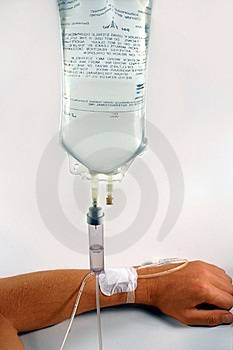

I'm planning on using some sort of glass container for the "reactor" now, but will the HCL be reactive towards airline tubing and an IV bag? I'm thinking of using something like this to control the drip rate

Reactivity of tubing... most plastics should survive if the acid is not highly concentrated, but the simplest answer is - check.
