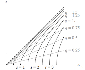

Consider a Rindler horizon, and the associated Unruh radiation.
Just like in your openning paragraph, an observer far from the horizon and thus experiencing negligible proper acceleration (you could go to infinity to get your "infinity" observer as you call him) will see a object approaching the horizon take infinite time according to his watch to reach the horizon. He will also see the object bathed by an infinite amount of radiation before reaching the horizon.
Let's consider this scenario: described from an inertial frame, we see the global structure that is the rindler observer's event horizon. Imagine a baseball made of normal matter, and a baseball made of anti-matter. The baseball is on one side of the event horizon (inside the Rindler observer's past light cone), and the anti-baseball is on the other side. The baseball is thrown towards the horizon, and the antibaseball is in a trajectory so it is on the otherside to meet the baseball just as it crosses.
Alright, this is just good old flat-spacetime. What happens?
If the Rindler observer is always at constant acceleration, the baseball with never reach the horizon in any finite time on his watch. The baseball will be bathed with infinite amount of radiation.
From the baseball point of view, nothing spectacular happens as it crosses the horizon, and it reaches it in finite proper time. Upon crossing the horizon, it is annihilated, but the radiation from that anhihilation can never reach the Rindler observer.
Yes, to our intuition these sound contradictory.
But no, the math is consistent. Where our intuition fails is the expectation of "observer independence" of particle number.
Do we at least agree to this point?
The next issue of intuition failure is the fact that the Rindler observer's coordinate chart doesn't cover all of spacetime. So while what you are implying would be like claiming the "annihilation event" never occurred according to the Rindler observer, that is not actually the case. He doesn't have a coordinate to assign to that event, according to his coordinate chart. That is completely separate from the claim that the event doesn't occur. He also cannot physically measure that it occurs, since the event is outside his light cone, but again, that is distinct from claiming the event didn't occur. For the event did, objectively occur.
So the second intuition issue is taking coordinate labels as too "physical". I have trouble describing this one well (it's come up in many other contexts with people asking questions on this site, and I'm often not able to help them see this clearly). So hopefully someone can word or describe it much better than I. Anyone? Please? I would like to learn how to describe this better.

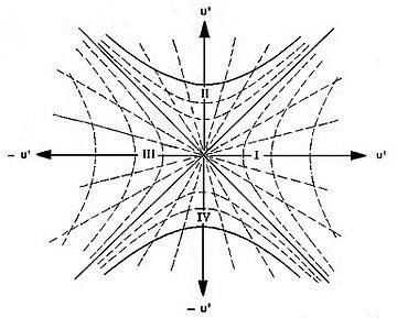

But that's just in a particular coordinate system which is badly-behaved on the horizon, namely Schwarzschild coordinates. Other coordinate systems on the same spacetime don't say the coordinate time to reach the horizon is infinite--see Kruskal-Szekeres coordinates for example. And contrariwise, even in ordinary boring flat SR spacetime you can come up with coordinate systems that are badly-behaved at some boundary, in the sense that the coordinate time to cross that boundary is infinite--this is true of Rindler coordinates, an accelerating coordinate system in flat spacetime where it takes an infinite coordinate time for anything to cross the Rindler horizon (in fact there is a close analogy between these cases, if you plot lines of constant Rindler position and Rindler time in an ordinary Minkowski diagram where the vertical and horizontal axes are those of an inertial frame, it looks just like what you get if you plot lines of constant Schwarzschild position and Schwarzschild time in a diagram where the vertical and horizontal axes are those of Kruskal-Szkeres coordinates...compare the yellow diagram on the Kruksal-Szkeres wikipedia page with the second diagram on the Rindler horizon page).
Basically the lesson is, don't take "coordinate singularities", where some coordinate-based quantity like the time dilation of a clock relative to coordinate time goes to infinity, too seriously. The only singularities that are really physical are ones where some coordinate-invariant quantity goes to infinity, like singularities in the curvature of spacetime which occur at the center of a black hole. Likewise the only notion of "time" that's really physical is proper time along some worldline, and both Schwarzschild coordinates and Kruskal-Szekeres coordinates predict it only takes a finite proper time for an infalling observer to cross the horizon (though in terms of Schwarzschild coordinates, what you'd actually show is that in the limit as the distance between the falling observer and the horizon goes to zero as the coordinate time goes to infinity, the proper time approaches a particular finite value, the exact same value that in Kruskal-Szekeres coordinates is the proper time of the falling observer at the moment she crosses the horizon).
  • #32
I respectfully disagree. Kruskal coordinates have problems with the OP also (remember, I am using the infinite observer's frame which presents Kruskal indeterminability). My OP is quite simple: if the black hole region evaporates in finite time, and mass crosses the EH in "infinite" time, then then black hole region is gone before any mass reaches it. It really doesn't need to be much more complicated than that, and the aesthetic advantages of this interpretation are indisputable (aren't they?).
  • #33
What does "Kruskal indeterminability" mean? What exactly is indeterminable? Remember that Susskind's discussion of two different opinions on what happens to the falling observer had to do with speculations about quantum gravity, there are no such disagreements in classical general relativity (although certain observers may not be able to see certain events that others can see due to event horizons)
Also, note that observers don't really have "frames" in general relativity, except for locally inertial frames in regions of spacetime small enough that the curvature is insignificant. In SR we can talk about an observer's frame as just a shorthand for the inertial frame where they are at rest, since there is a unique way to construct an inertial frame for any inertial observer (aside from the position of the origin and the orientation of the spatial axes), and inertial frames are "preferred" in SR (the basic equations of SR like time dilation only hold in inertial frames, and the laws of physics obey the same equations in all inertial frames). But in GR the principle of "diffeomorphism invariance" means that the equations of GR hold in any arbitrary coordinate system, so there are an infinite number of different ways you could construct a coordinate system where a given observer in curved spacetime is at rest, and none of these different coordinate systems would be preferred over any other. So, talking about an observer's "frame" in a decent-sized region of curved spacetime does not pick out any unique coordinate system, and thus the term isn't really meaningful in this context, so physicists don't talk about the "frames" of GR observers.

The event horizon is not simply the distance where the "escape velocity" is the speed of light. "Escape velocity" is a concept from Newtonian physics which does not really explain what's going on in general relativity, although authors writing for a popular audience do sometimes simplify the concept of an event horizon in this way. In Newtonian physics, it's quite true that if the escape velocity at radius R is vR, an object traveling outward from just under R with v < vR can travel out past R, it just won't "escape" in the sense that it will eventually start falling back down. However in GR, where we are dealing with curved spacetime, the situation is totally different--for any event which occurs on or inside the event horizon, spacetime is curved in such a way that the entire future light cone of that event remains inside the horizon, so no worldlines passing through that event can even briefly stray outside the horizon. This can be illustrated nicely if we use Eddington-Finkelstein coordinates, where the future light cones of different events actually tilt over for events closer to the horizon (as discussed here), you can see visually that future light cones of events on or inside the horizon don't have any part outside the horizon:
[URL]http://www.etsu.edu/physics/plntrm/relat/eventho1.gif[/URL]
[URL]http://www.etsu.edu/physics/plntrm/relat/eventho2.gif[/URL]
(images from http://www.etsu.edu/physics/plntrm/relat/blackhl.htm)
