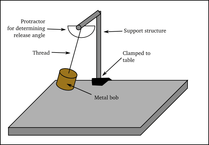

In my intro mechanics lab class, we did an experiment where we measured how much energy was lost in a pendulum over 300 seconds. In my case, the final energy of the pendulum was 2.4% what the initial energy was.
The pendulum was constructed by attaching a cylindrical metal bob to a thread.
Today I tried to simulate that system using a computer. I came up with this equation of motion:
[itex]\ddot{\theta} = - \frac{g}{l} \sin \theta - \frac{1}{2m} C_D \rho A l \frac{\dot{\theta}^3}{|\dot{\theta}|}[/itex]
Where the last term is due to the air resistance on the bob:
[itex]F_D = \frac{1}{2} C_D \rho A v^2[/itex]
I estimated the drag coefficient [itex]C_D[/itex] to be somewhere between 0.5 and 1, based on the values I saw in the figure in the top right of http://en.wikipedia.org/wiki/Drag_coefficient" .
When I ran the simulation, the final energy/initial energy ratio turned out to be 33%, even taking [itex]C_D[/itex] to be my maximum estimated value, 1. So what I'm wondering is: what other sources of energy loss might there be that I'm not thinking of? I realize that I'll never be able to get the exact value, but I should be able to get something closer to 2.4% than 33% is.
I attached the program (it's in C) in case anyone cares to take a look. If you have gcc, you can compile with `gcc -o pendulum -lm pendulum.c` and run with `./pendulum`.

Hello just a nobody.The vibrating pendulum sets the support structure into vibration as well.Depending on how well this is constructed and set up it can be a major source of energy loss.
Interesting. It looks to me like you've done it all correctly. The problem is probably that there are other energy loss mechanisms, as you say. In addition to what Dadface says, there might be drag on the string itself that you could add in, and there might be energy losses from flexing the string back and forth. You might try fastening it to a more rigid support to eliminate the losses Dadface refers to, and using some sort of bearing at the pivot point to minimize those losses. Another thing you could try is to use multiple bobs of different areas and plot the energy loss as a function of area, then extrapolate back to zero area. Then you could quantify how much of the energy loss comes from drag on the bob and how much comes from "other stuff". Then you could work to minimize the "other stuff"

Another source of loss could be the linear (viscous) drag term, which was set to zero in the simulation. I myself am not sure of the relative magnitudes of the linear and quadratic drag terms, if I can find my old notes on them I'll see about making a comparison.
Looking at the figure in Post #1, I wonder if the string could have been rubbing against the protractor?

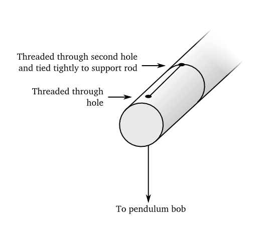

Well, where is your friction at the hinge??
That is:
As the string (bound tightly around some axle?) will slide and shift, there will be quite a lot of energy loss there as well, not just energy loss due to air resistance.

This is the first thing that jumped out in my mind as well.
Now, a modelling suggestion for torque produced by friction at the axle:
I base my idea on the assumption that the string is "tightly" wound up around a stationary axis. It will still slide back and forth a bit.
Assume a Coulomb law, letting the string tension substitute for the normal force.
If "r" is the radius of the axle, you should have a damping torque as follows:
[tex]\tau=r\mu(mg\cos\theta+ml\dot{\theta}^{2})[/tex]
where the frictional coefficient is between the material of the string and the metal of the axle.

The string isn't fastened like that. Sorry if my drawing was misleading. I attached a close up of where the string attaches to the support rod.
