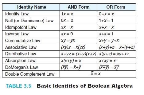

What are the basic Boolean identity equations? Please list them for us, and tell us which ones you think might apply.

Thank you so much
here is the table from my course book
