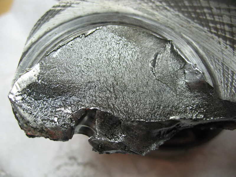

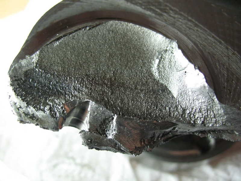

I have a broken crankshaft where I am trying to determine the cause of failure.
here are some pics of the cracked surface.
what is known:
1) the crank shaft was under very light load at time of failure
What do you guys think?
Fatigue. Crack propogation originating from the oil drilling shown.
Thanks for the reply, could you explain how you are able to tell this?
1) Beach marks clearly visible showing nucleation site is likely somewhere around the fracture face on the drilling.
2) 90% of the time they fail like that.
