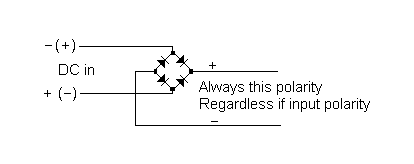

Hi There
Assuming we are referring to DC voltage supply from the strips to the dodgem car sorting out the polarity is easy. One common way is to use a bridge rectifier it doesn't matter what polarity the DC is applied to the AC terminals the rectifier will always produce +DC on the + terminal and -DC (0V) on the negative terminal
its a method many of us use in portable equip in the field, powered off batteries, where it could be easy to accidentally reverse the DC supply connections
Dave

I would assume you would need at least four brushes to assure you were always in contact with both supply rails. The following diagram would use two diodes per brush to achieve a DC signal to the motor regardless if the rails were AC or DC.
Fish

That's what I was after, thanks Dave.
Yes Fish, though 3 brushes would be suffice?

Fish: You probably want to switch polarity on one row of diodes.
xanhast: Not quite sure but I guess the voltage is relative low.

You would have to work out the geometry; I would guess that it could be done with three, but I am sure it can be done with 4 :-)
As far as "Safe"...hrmmm, not entirely sure the old ones were safe, LOL. The "old ones" used the floor for one leg (I would assume ground) and the roof for the other (eliminating the need for geometry AND rectifiers). I would guess that the "new ones" using the floor in your picture, simply use relatively low voltage DC (12V to 48V), and that the source is turned off when people are on the track (and not in the cars).
