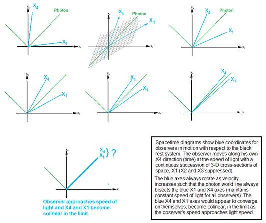

Of course I do not know the answer to your question. However, you might be interested in considering the following. Perhaps nature decided to manifest its physics on a R4 manifold with a 4-dimensional space populated with 4-D observers. Observers could take the form of objects with relatively long world lines (relatively short 3-D lengths) oriented in various ways. Affine coordinates were selected as a background for the natural positioning of the 4-D objects in patterns that would manifest physics. That is, the same physics would be manifest to all observers, regardless of the orientation of the world lines.
There are world lines for inanimate 4-D objects and worldlines for 4-D observers. However, the world lines, extending along the X4 axis of a given object, would be oriented with angles that would not exceed 45 degrees. Along with this, observers experience the phenomena of time--the observer (in some sense) moves along his world line at the speed, c. And any observer, at any instant of time, would "live in" a 3-D cross section of the 4-D universe at the corresponding point along his world line. Further, that view would be along X1 of his affine coordinates (X2 and X3 are suppressed in this example).
In the sequence of views below, different observer world lines are shown, corresponding to increasing velocities with respect to a rest frame. The X1 axis always rotates to an angle symmetric with the X4 relative to the 45 degree world line. You see that if the world line of an observer rotated 45 degrees clockwise, then the X1 would rotate 45 degrees counter clockwise, and the X4 and X1 would then be colinear. That would represent some kind of physical boundary--the observer would not be able to make any sense of such a 3-D cross-section view of the manifold. Correspondingly, the physics is designed to avoid this colinear result for observers.
Of course that 45 degree world line is a 4-dimensional photon, having the velocity, c. Thus, the speed of light, in this fanciful description of 4-dimensional space inhabited by 4-D observers, is a natural consequence of an affine space designed for 4-D observers who must experience the same physics, regarless of their world line orientation. Accordingly, all observers will obtain the same value, 186,000 mi/sec, when measuring the speed of light, regardless of an observer's speed.

Thank you for your answer, but I don't understand it :-( One reason is the terminology. I am very good at explaining anything to anyone. It is a rare talent I have. But first I need to understand it. I am hoping somone can explain it to me closer to the way I would. Not assuming one knows what manifolds and world lines are. To break it down step by step. Illustrations would help/ I don't understand the one above.
I will try to read this more times and see if I can translate it.

I think the spacetime diagrams with the world lines might be a way for you to grasp some fundamental concepts. I realized that you might not understand the diagrams at all, but I didn't really know your background well enough to judge. It was a description that I hoped would not get too detailed and lengthy.
I can walk you through the understanding of the spacetime diagrams if you wish to pursue things in that kind of detail. And there are others on the forum here who are better than I at explaining things.

Regarding th diagram, what are X1, X2, X3, and X4? Is X4 the observer? Why does it also say X4 is time? I can't make out what is at the end of the black lines. It this a 2D graph? What does it mean by the blue axes rotate?
"The blue X4 and X1 axes would appear to converge on themselves, becoming colinear, in the limit as the observer's speed approaches light speed."
Huh? LOL "in the limit"? "appear to converge"? What does how something appear have to do with how fast things can travel?

This is excellent. I think this is headed in the right direction. Conceptually, the important form of the equation e=mc^2 is c=squarroot(m/e). The real question is why is the speed limit of the universe equal to the square root of the mass of any object divided by it's energy. I get the feeling that it must be, by the very definitions of what mass and energy are. I don't see it yet though. I think this is very close. Something to do with the fact that energy is motion. I will think about it. If anyone can illustrate why that must be so, please do.
The square root of mass divided by energy. Hmm...
You are going down the wrong path. First figure out what you have to go off and study to understand bcrowell's first post (he has written a first class book on gerneral relativity, but it may be advanced from where you seem to be with your background). Google special relativity and also spacetime diagrams and see what you come up with.
