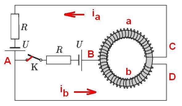

Hi! This problem was posted last month, and the due date was on the 10th so I can ask now.
Here is the problem: http://www.komal.hu/verseny/feladat.cgi?a=honap&h=201102&t=fiz&l=en"
problem # P.4325
Kirchoff's laws
I know the magnetic flux can't change suddenly in time, which means that after closing the switch the total current inside the thoroid must remain I0. However, I have no idea how to calculate how much of this current goes through the "top" half of the toroid, and how much through the bottom. If I knew that I would be done, since the difference of the two is the current going through the switch. If anyone could start me off and guide me through this problem that'd be great and much appreciated.
Thanks!
-Tusike

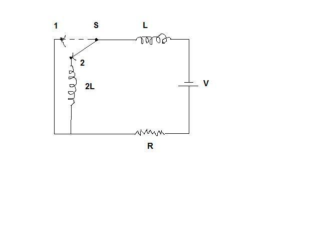

I am posting a problem which I think is similar to this one. Try it if you want to.
In the circuit shown, the switch S is shifted to position 2 from position 1 at t=0, having been in position 1 for a long time. Find the current in the circuit as a function of time.
Ask me if you have any problem here.

The coil cannot be broken into 2 separate coils!
To explain why briefly, that's because there is magnetic flux linkage between the upper half and the below half of the coil, i.e. B-field by one half penetrates into the other half. If they were 2 separate coils, their magnetic fields would be separate.
Okay, then why B-field by one half can penerate into the other half? That's because of the iron core. One important characteristic of the coil of whose rounds are linked by ONE iron core: The magnetic flux through each round is the same and is the combined result of B-field by all rounds.
In this problem, there is a difference between the current of the upper half [tex]i_a[/tex] and that of the lower half [tex]i_b[/tex], so I suggest you should go back to the most fundamental.
For an isolated inductor (i.e. there is no other B-field penetrating into it or any external wire connecting to the middle of it like in this problem), current through the inductor cannot change immediately: di/dt = 0; but the reason behind that is the magnetic flux through the inductor cannot change immediately, and since the inductor is isolated, magnetic flux ~ i, and hence, i cannot change immediately.
(1): Therefore, for this problem, the magnetic flux [tex]\Phi[/tex] through the whole coil cannot change immediately.
(2): Suppose that the iron core is uniform and linear. Plus the fact that the 2 halves are geometrically identical, we have B-field by each half is: [tex]B_a = ki_a[/tex] and [tex]B_b = ki_b[/tex]. Notice that the proportional coefficient k is the same for the two halves, as they are identical.
(3): We have [tex]\Phi \propto (B_a+B_b)[/tex]. Hence: [tex]\Phi \propto ki_a+ki_b \propto i_a + i_b[/tex]. Notice that conventional directions of both currents are the same (see picture), and because of that, we have [tex]\Phi \propto (B_a+B_b)[/tex]; otherwise, it would be [tex]\Phi \propto B_a - B_b[/tex].
From (1), [tex]i_a+i_b[/tex] cannot change immediately. Right before K is closed: [tex]i_a+i_b = 2I_0[/tex]. Thus, right after K is closed: [tex]i_a + i_b = 2I_0[/tex]. Notice that the sum is [tex]2I_0[/tex] but not [tex]I_0[/tex] (as initially, right before K is closed, [tex]i_a = I_0[/tex] and [tex]i_b = I_0[/tex]).
(4): As the magnetic flux through each round is the same (because of the iron core) and the two halves are identical and thus have the same number of rounds, the induced emf's on both halves are the same. Therefore: [tex]U_{BC} = U_{DB}[/tex]. Notice that [tex]U_{BC} \neq U_{BD}[/tex], as when we say the magnetic flux through each round is the same, we implicitly understand that the magnetic flux goes through each round in the same direction.
(5): Write down Kirchhoff equations and solve :wink:

From you're 5 steps, one of my mistakes was that I had [tex]i_{a}[/tex]+[tex]i_{b}[/tex]=[tex]I_{0}[/tex], I see now how that's very wrong. And I didn't realize that the two emf's were equal, so I had two L*dI/dt parts in my equations, for the dI in the a and b current. So I couldn't solve that:) Anyway, here are Kirchoff's equation I wrote down now:
For the ADBCA loop (the one without the switch):
(1) U-2U(BC)-[tex]i_{a}[/tex]R = 0
For the ABCA loop:
(2) 2U-U(BC)-[tex]i_{c}[/tex]R-[tex]i_{a}[/tex]R = 0
And the ABDA loop:
(3) U + U(BC) - [tex]i_{c}[/tex]R = 0
And we have the following equations as well:
(4) [tex]i_{a}[/tex]=[tex]i_{b}[/tex]+[tex]i_{c}[/tex]
(5) [tex]i_{a}[/tex]+[tex]i_{b}[/tex]=2[tex]I_{0}[/tex]
(6) [tex]I_{0}[/tex]=U/R
From (3) we have U(BC) = [tex]i_{c}[/tex]R - U, substituting that into (1) and using (6) we get:
[tex]i_{a}[/tex]=3[tex]I_{0}[/tex]-2[tex]i_{c}[/tex]
We can add (4) and (5) to get rid of i(b) so we get:
2[tex]i_{a}[/tex]=[tex]i_{c}[/tex]+2[tex]I_{0}[/tex]
So from this equation and the one before, I got that [tex]i_{c}[/tex]=[tex]\frac{4}{5}[/tex][tex]I_{0}[/tex], with the current "moving" towards the toroid.
I think that's correct. Thanks very much!
-Tusike
