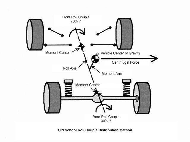

I'm studying the chapter 'Steady State Cornering', from the book 'Fundamentals of Vehicle Dynamics' (by Gillespie).
The concept of a 'roll center' seems to be very important here, especially after the 'roll axis' is defined (line joining the front and rear roll centers). But I don't understand what a roll center is, in the first place, can somebody please help me out?

The second part is perfectly clear, but I'm having trouble with the first part. Generally, wouldn't the Roll Center simply be the center of mass of the sprung mass? Any force that doesn't pass through it would have a moment about the COM, resulting in a tendency to roll right?
The book also says
The roll center can also be thought of as the point on the body at which a lateral force application will produce no roll angle, and it is the point around which the axle rolls when subjected to a pure roll moment.
Now where is the axle coming into the picture now? I thought the RC is a property of the sprung mass? And also, the roll center seems to be really close to the ground in diagrams, like, completely away from the body.

Let's look at a really simple suspension. In the next picture, you can see that the tractor has a simple solid axle for the front wheels. There are no springs, the axle is just rotating about the pin at the center (There is no suspension at all for the rear axle).
The pin is the roll center of the front axle. In this particular (really simple) suspension, no matter how the «sprung» mass (the tractor frame) is positioned with respect to the «unsprung» mass (the front axle), the roll center position is always clearly known.
Now, this tractor is not built for cornering, but let's imagine that the rear axle is built the same way and that there are left & right springs between each axle and the tractor frame. The roll axis would be the imaginary line linking both rear and front pins.
If that tractor would be under lateral acceleration, the centrifugal force (ma) would act at the center of gravity of the sprung mass. The distance between the center of gravity and the roll axis would create the moment arm for the centrifugal force. That moment (or couple) would begin a rotation of the sprung mass around the roll axis. This rotation (or this moment) will be opposed by the moment created by the spring force and how far it is from the roll center. These moments will be balanced when the rotation stops to a certain angle. The larger the lateral acceleration, the larger the final angle.
Now imagine that the pins are moved high enough that the roll axis goes through the center of gravity. In such a case, there will be no moment created since the moment arm length is zero. Hence there will be no rotation initiated and the tractor would stay perfectly parallel to the ground under any amount of lateral acceleration.
For more complex suspensions (with more links), the position of the roll center depends on the position of each link. Since those links are constantly moving, the roll center is also constantly moving. And that's where the fun begins in suspension design ...

That was beautiful man, thanks a lot! I still don't get how you calculate the position of the RC in more complex situations, but I think I understand the concept, how it works, and why it's so important. I'm finally able to make some progress with my book. Looking forward to the 'fun' you were talking about, I think that comes somewhere in the next chapter!
