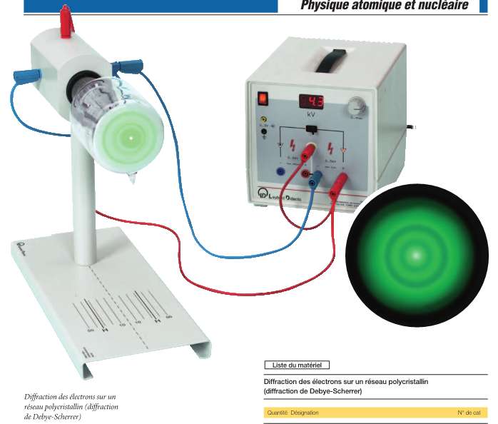

Let's return to the real world.
In the real world, the electrons are not fairy beasts, but are used by industry and scientific research for more than a century. Vacuum diode exists for 1904, triode for 1907. Cathode ray tubes exist for 1907. X-Ray tubes are in use in radiography for the first World war.
Electron beams are also used for microscopy, by transmission or by scanning, in microprobes, so on.
They are not as good as X-Ray are in crystallography, for their poor parallelism and poor monochromaticity. However we obtained Laue diffractograms of carbide inclusions on a Siemens electronic microscope, just by modifying the focalization and diaphragming on the inclusion.
And electron beams are also used in nuclear industry, for very deep and narrow weldings.

In the real world, we are trying to have better experimental values of the real width of an electron, depending of its momentum and the length of its path. Here we seem to be in the 10-15 Å range, and if true, it is by far too narrow for a successful double slit experiment (too narrow or too fast, it is tight together).
Such equipments for Debye-Scherrer diffractograms with electrons are sold by Leybold Didactic for our classrooms :
Catalogue at : http://www.systemes-didactiques.fr/include/physiquechimiebiosvt/tube.pdf
This tube seems no more available at http://www.ld-didactic.de ([VP6.1.5.1] · Diffraction of electrons at a polycrystalline lattice (Debye-Scherrer diffraction)).
You see that they use higher voltages to obtain more Bragg reflections on a small screen.
The angular resolution is poor. We obtain far better results with [itex]K \alpha[/itex] of a metallic anticathode.
Now the question arises : what causes such a poor angular resolution ?
  1. The crystallites in the metal or graphite sheet may be too small.
  2. Each incident electron may be too small. However, it must be at least three to four interatomic distances long, and five to six interatomic distances wide, otherwise not any diffractogram could be seen at all.
  3. Too much speed dispersion in the electrons beam.
  4. Too much angular dispersion in the electrons beam.
To know more on the length of coherence of an electron in a beam, one must make the electron interfere with itself. So in Aharonov-Bohm type of experiments, the speed and the accelerating voltage are much lower. As far as I know, the so proved length of coherence is in the magnitude of ten wavelengths, at least.
To be continued.
