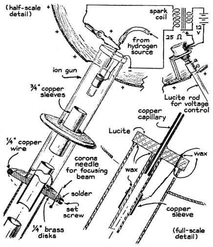

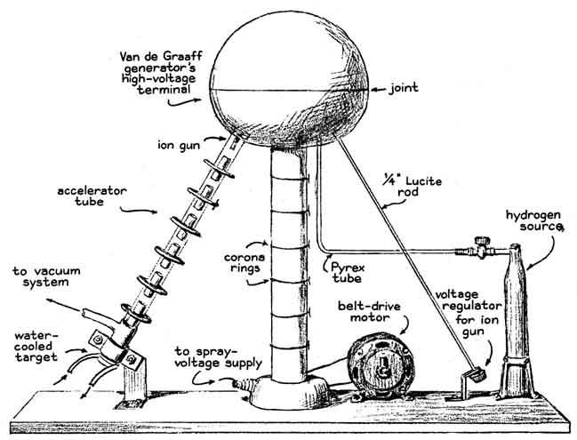

I'm a high school student and i have a great interest in particle physics. I'm looking to build a small linear particle accelerator. I have come across the designs attached
i was wondering if there is a simpler design? I'm new to the forum so any help would be greatly appreciated.
Thanks
First, do you have any knowledge of how to safely use high voltage and how to deal with radiation? Those are REQUIRED if you are going to build anything like this.
Yes i have prior experience with high voltage applications (examples, 900,000 Volt Tesla Coil-500,000 volt Van De Graaff generator. all of which i have built.) I am familiar with the fact that particle accelerators emit radiation. I would like some help and information about controlling the radiation and protecting my self from it, there was some suggestions in the attached link to a pdf file on the last page on protection from the radiation. I understand this is a very complicated project. I'm just trying to accelerate particles at a slower rate than what this particular design runs at. I'm not trying to create antimatter or anything of that nature, I'm just trying to run my own experiments in which i can study the collisions of atoms.
http://www.sciencemadness.org/talk/files.php?pid=91439&aid=2765"
i was also planning on running this in my backyard as it is about 1/4 of an acre. By controlling it remotely, about 25 to 30 feet away using a switch board and a wireless camera. I would suppose this would eliminate the possibility of becoming in contact of any radiation, gamma rays and x-rays. The link to the pdf recommended using 18 inches of concrete to shield yourself, which i would have no problem setting up, in which case it will probably be more like 25 inches just to be safe.

One other dangerous aspect is the hard vacuum that you need to pull. There is a lot of energy stored in the pressure gradient across your vacuum enclosure.
As long as you follow appropriate safety measures you should be fine. It looks like you already work with high voltage, so as long as you learn how to deal with radiation you should be ok. It really doesn't seem that much more dangerous than building a homemade Fusor. (Tabletop fusion reactor)
Hit up the forums at fusor.net and you can find a lot of info buried around in there about appropriate ways to deal with the hazards related to what you are wanting to do. Just realize that you CANNOT cut corners with safety. And especially if you do this in your backyard or somewhere with nearby neighbors.
Also, it is very unlikely that you will really be able to learn much from a homemade accelerator in my opinion. We've had accelerators for over 50 years, ranging from small ones the size of something you are thinking of making, up to the Large Hadron Collider. I'm not sure what you would really gain from making one of these.
