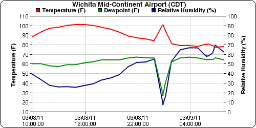

Here's what really happens when air from the upper atmosphere for various reasons plunges toward the surface:
Witchita, Kansas June 6, 2011 heat burst
http://www.accuweather.com/blogs/weathermatrix/story/50816/wichita-heat-burst-last-night.asp
Wichita, Kansas experienced a "heat burst" last night. Their temperature spiked from around 80 to 100 near midnight, then dropped back down. Their humidity went from around 55% to 7%, then back up, all in less than two hours.
A National Temperature Record at Loma, Montana
http://ams.confex.com/ams/annual2003/techprogram/paper_54387.htm
On January 14th-15th, 1972, a National Weather Service cooperative observer site located in Loma, Montana recorded a 103F temperature rise (-54F to 49F) within twenty-four hours, thereby breaking the previous national record of 100F fall set on January 23-24th, 1916 in Browning, Montana.
Downbursts such as these (heat burst, Witchita; Chinook wind, Loma) don't always make the local temperature hotter. If the incoming air is cold enough aloft it can still be colder than the air it replaces when it hits the ground. Sometimes the Santa Anna winds make LA get hot and dry, sometimes cool and dry. However, you'll never see air moving so fast that it forgets the laws of physics.
