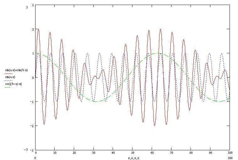

Studiot, you may want to rephrase that, or maybe I am not reading you correctly. Summing two signals will not generate new signals.
Just to clarify here is the result of adding sin(x) and sin(1.1x) :ie a=1, b=1.1
The red trace is the sum of the sine waves.
The blue trace is the single sine wave sin(ax) with a=1 for reference
The green trace is the new frequency (beat) frequency that appears at 0.1 units and is cos((b-a)x). I have shown this as a cosine wave as this is in sync with the red wave as shown by my earlier formula.
Charles is correct that you get a repetitive wavetrain at this frequency.

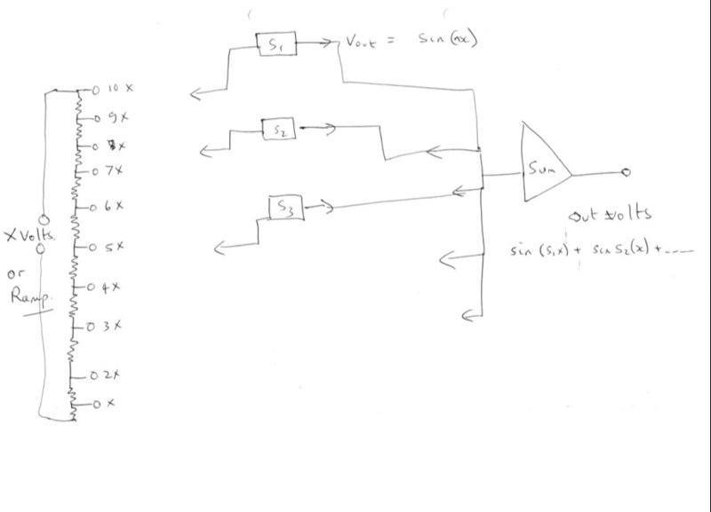

However why can you not represent your signal by voltages? This makes scaling much easier.
Yes I am thinking along the lines of an analog computer. Any good analog computing references would be much appreciated.
What exactly do you mean by representing my signal as voltages? I'm not very knowledgeable about electrical engineering or circuit design so I apologize if that is an overly basic question. If there is a way to represent the signal other than as an alternating current, I am open to that sort of idea.
As you've probably noticed, my ideas are still in the early stages - none of the specifics are 100% rigid so long as I can output a signal with an arbitrary integer scaled frequency/wavelength/period.
Here is a rough sketch showing what I mean.
Let us say we have a voltage V volts equal to 10x.
We can very simply divide this down either by a switch as shown in discrete steps or continuously by a potentiometer.
Thus we can generate a voltage = nx for any n.
An analog circuit block that takes an input voltage v and outputs the sine of this voltage =sin(v) is a readily obtainable/ constructable unit.
If you take a number of these for n1, n2, n3 etc you can easily combine them to obtain the sum of these voltages which is therefore the sum you require.
This is the basis of an analog computer, many other functions besides the sine are availbale this way.
Traditional analog computers used fixed voltages, which is equivalent to looking up the sine of a certain number in tables.
If you require scanning you can substitute a ramp voltage at the input so that you can obtain an output voltage which tracks the variation of x at the input and produces an output which is the sum you require over the range of x input.

Studiot, what kind of analog devices are there that compue a sine function of the input, never heard of these. And how do they help at generating a sine with the input voltage as a frequency?

I said that if you represent x by a voltage you can easily obtain another voltage given by
f(x) = sin(n1x)+sin(n2x)+sin(n3x)+..+
where the ni are coefficients.
From what we have been told, I think Charles would be better served working with voltage to create his required functions.

This is the closest I have got
I'm trying to construct an analog calculator of sorts,
see posts 8 and 9

I have shown that the product of two sinusoids is equivalent to the sum of two sinusoids twice already in this thread.
This is standard stuff that may be found in most textbooks on the subject.

This shows that the sum of two sine waves is the product of a sine wave and a cosine wave..
Conversely the product of a cosine wave and a sine wave is equal to the sum of two sine waves
true enough at any instant from our high school trig identities. i looked them up.
