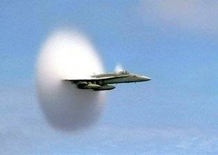

But you saying that fiber pushes wave to change its direction, if source can push the wave to change its direction then it obviously can change its speed. Because changing the direction is the property of speed of source, and the property definitely can affect the speed of wave if wave is in same direction of source.
http://www.nasa.gov/audience/forstudents/5-8/features/what-is-supersonic-flight-58.html
Suppose, that plane is on ground with running engines, then its sound waves travels in sphere. But if plane flying with super sonic speed then it creates cone of sound wave because forward waves cannot chase plane, and with upper and lower waves it creates cone. If as you say source can change wave's direction then there is a sound disk not cone.
But as we know source speed cannot affect speed of wave, so source cannot affect wave's direction too.

But it will not showing wave in inclined path, because it transmits wave to all direction.
Suppose, if source is stationary in your video then what would be the path of the traveling circle?
