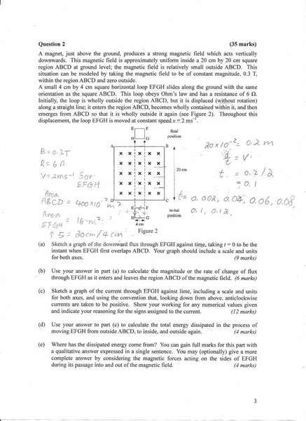

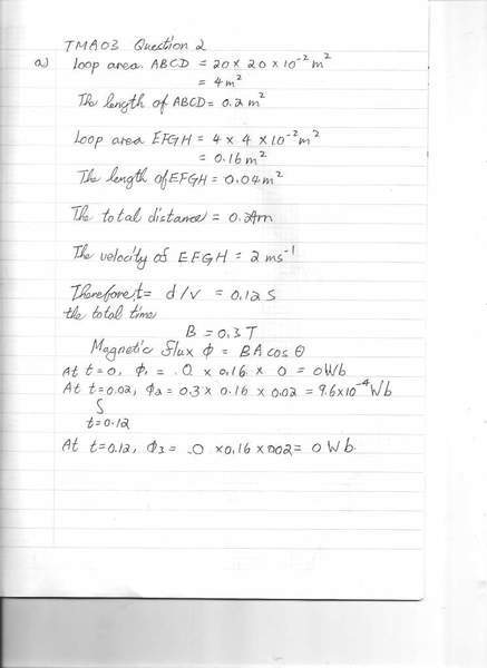

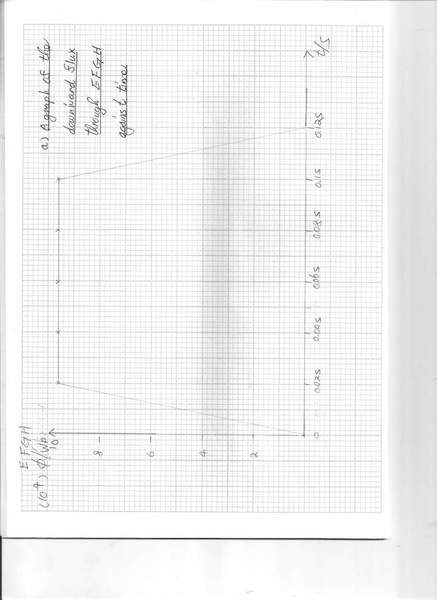

Please let me know whether it's wrong for my attached solution.
magnetic flux = BAcosθ
I don't know how to calculate the part (c) as attached file, please advise!
