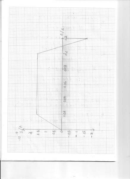

Please let me know whether it's wrong for my attached solution.
i = (d∅/dt)/R
In part (d), does it calculate wrong??
In part (e), where has the dissipated energy? is it for heat energy??
Thanks!

Please advise!
