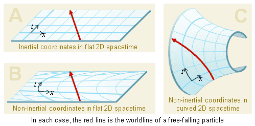

A. Consider a freely-moving object when there is no gravity. We know such an object moves in a straight line at a constant velocity (relative to any inertial frame). If we draw a graph of distance against time on a flat piece of paper, we get a (red) straight line. Even if the object is at rest in the frame, we get a line parallel to the time axis, not a point.
B. Now consider the same freely-moving object with no gravity being observed by an accelerating observer. This can be represented by the same flat piece of paper as before with a red straight line on it, but now with curved blue grid lines instead of straight grid lines. If the red line starts off parallel to one of the curved blue gridlines, it won't remain parallel for long. In other words an object released from rest will appear to "fall" relative to the accelerating observer.
C. Finally, consider a freely-moving object falling under Earth's gravity. Now we need to draw our distance-against-time graph on a curved piece of paper. The object will now follow the straightest (red) line possible (a geodesic) on the curved sheet. The blue grid lines representing something at rest relative to the Earth do not follow the straightest routes on the sheet. If the red geodesic line starts off parallel to one of the blue non-geodesic gridlines, it won't remain parallel for long. In other words an object released from rest will fall.
Yes, that's the key point: every object has velocity along the time axis, so spaceTIME curvature causes even "at rest" objects to veer away from the path they would have without gravity.
If only space is curved, then there would be no gravitational force on objects at rest. But if spacetime is curved, then all objects are affected.
kweba I think it would help if you familiarised yourself with the concept of a 'four-velocity'. When you understand that concept you will see that there is no such thing as being 'at rest'. Every object has a nonzero four-velocity. Hence it has a unique geodesic that it follows - if it is free from non-gravitational forces. That geodesic is defined by its position and the direction in spacetime of its four-velocity.
ETA: looks like somebody has just explained this above, with diagrams too. Nice!
This is a nice way to see it and certainly describes why we fall, but actually if one considers B (that is in flat spacetime), it begs the question why curvature is needed at all for GR and gravitation; B would only need a mechanism of acceleration. So once we assume gravitation comes from spacetime curvature, C is not adding anything to the question why we fall.
How would the object in Example C fall if there was no curvature? I'm not entirely sure I understand the issue.
It is probably just nitpicking. I was only pointing out that in B you already have the object "falling" without having to curve the graph as in C, just by introducing acceleration (curvilinear coordinates) making C unnecessary.
I understand; you feel C is redundant.
However, taken together, B and C seem like a good example of the equivalence principle. And in the context of the original post, I think scenario C is nice to have.
Certainly.
