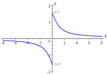

Or cot-1x.

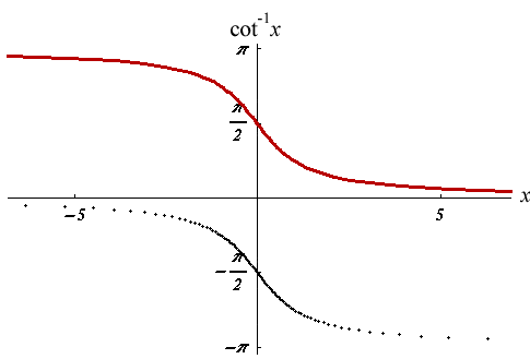

Bohrok said:
Or cot-1x.
The domain is not restricted and the range is 0 to ∏
What am I missing Bohrok? :)
Once again, I forgot about the true graph of cot-1x :rolleyes:
WolframAlpha likes to show the graph like this:
Hah, no problem, how does wolfram get this other graph?

How is it that wolfram has a completely different graph for the same function and still mean the same thing? I would guess it is changing one of the axes to be a different representation of the value, like how the sin curve is a graph of x vs y in radians as opposed to just its actual y values on the unit circle.
What's the scoop?
What's the scoop?
Which function are you referring to? [itex]\arccot(x) (= \cot^{-1}(x))[/itex], or the one I suggested? The problem with y = arccot(x) is that on computer systems a one-argument version of the function cannot tell which quadrant the resulting angle y should be in. Since cot(y) = adjacent/opposite, if both the adjacent and opposite sides are negative (i.e., the angle is in quadrant 3), then the minus sign cancels out, and so typically implementations of y = arccot(adjacent/opposite) don't know that and will put angles that are supposed to be in quadrant 3 into quadrant 1. Similarly, quadrant 4 angles get sent to quadrant 2. This leads to a discontinuity in arccot(x) when this definition of the function is used.
The typical example of this behavior is actually arctan(x). For the same reasons as for arccot(x), many computer implementations of arctan(x) have a jump discontinuity. As a result, a special function atan2(x,y) is available on many systems, where x is the adjacent side length and y is the opposite side length. The function atan2(x,y) places the angle in the correct quadrant and has no discontinuity.
