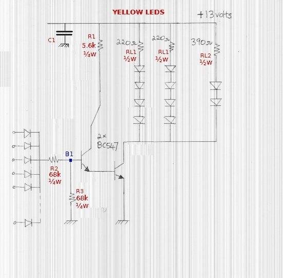

On examining the way the 4017 operates, I see you have to choose between:
(a) 10 blocks of yellow, with the leftmost never darkened; or
(b) 9 blocks of yellow, with the leftmost being darkened for 1/10 of the cycle.
This should be right for driving up to twelve of the yellow or red LEDs. Construct one to start with, and test it.
With it being able to drive 12 LEDs, consider making your yellow and red blocks multiples of 12.
The circuit to drive blue and white LEDs will be a bit different.

A couple questions about that.. I see the 547's set up as a darlington pair (read about that it my travels) is that to allow for higher current? Is this circuit going to condition the voltage or current to save the life of the LEDs? You had mentioned that using car power voltage will fluctuate. I'm guessing that the LEDs are on the right, are those other 5/6 on the left diodes for one way power travels? And what value is C1?
Last question because I'm newer to electronics, I'm cheap, and I'm excited so I'm in a hurry (I'm working on that one) is it not advisable to just do something like this:
led.linear1.org/led.wiz/?VS=13&VF=2.8&ID=30&N=10&output=s
Sorry for all the questions, I do not doubt your help. I want to learn and understand as well as accomplish my goal.
Thanks!
It means the circuit will take very little current from the 4017. The 4017 data sheet shows it can output currents of only about 10mA. This is not sufficient for your needs, where one of the 4017 outputs will be driving maybe 14 separate blocks of LEDs, so a Darlington pair is needed to minimise the load on the 4017.
This limits the current to the LEDs to about 22mA. should battery voltage rise to 13.8v.
The small signal silicon diodes on the left form an OR gate and they come from outputs 1-9 of the 4017. Different blocks will have different numbers of diodes connected to different 4017 outputs to set it in the blinking sequence. C1 is an electrolytic, say 220μF, 25v but not needed at this stage.

I can't seem to find 547 transistors very easily. Can I use 2222 or 3904 instead?
The 2N2222 should do just as well.
Then B. I would like the leftmost one to darken. That is how the real ones do it so I'll shoot for that.

  • #31
Important: the 2222 has a lower gain, so change R1 to 3.9kΩ (Always check initial operation: no components should get hot, not even warm to the touch.)
You might find it useful to construct just one circuit for testing purposes, and power all three colours from it simultaneously so you can photograph them together and, if necessary, set each to a more-suitable brightness.
So, using that basic circuit, instead of the 10 yellow LEDs, you could have:
one string of 4 yellows in series with a 220Ω, plus
a string of 4 reds in series with 220Ω, plus
a string of 2 blues in series with 390Ω, plus
another string of 2 blues in series with 390Ω
This would give 4 of each colour, and give you the opportunity to modify the resistor values to determine best luminosity for camera work. Don't forget that when the car's voltage varies these LEDs will change brightness a bit, too. https://www.physicsforums.com/images/icons/icon6.gif
  • #32
Well went to an electronics parts place in Mesa today in hopes of finding the 547s. The 2222 are 2 bucks each at the radio shack so no thanks. I'm ordered 50 547Cs for $6, should be here in a few days.
I'm planning on doing the first circuit on a breadboard with the multiple colors to test like you suggested (good thinking!) and the solder together my sections of 10 LEDs each.
I'm going to use a 555 to turn the blocks on and off to test from pin 3. I think that's right. I'll alk to you in a few days.

  • #35
Using 4017 is by far the simplest method, in principle, for what you are doing, because the sequences are locked together and controlled by a single clock. To speed up or slow down the rate of blinking you'll just adjust one 555 and there are no timing issues. However, it also follows that you can't independently control things, so in that sense your options are limited. If you wanted 3 successive blinks, you'd need to use two 4017's with this timing method.
I thought you said you had already built the basic 555 + 4017 circuit? How much did the 4017 cost?
While cooling your heels, you could turn to the task of figuring out how many input diodes you'll need for each of the 9 yellow blocks. This means you have to work out what combination of outputs from the 4017 is needed for each yellow block to turn it on and hold it on. Maybe start with the timing diagram here: http://electronics.stackexchange.co...-multiple-connections-in-this-traffic-light-c
You'll also need to search for the full 4017 pin-out.
You might re-consider the 2222's. If you use 547's throughout you will have to construct at least 5 blocks to do what a single 2N2222 can. The 2N2222's are rated for more current, so one 2N2222 can drive half of the blues together with half of the reds (providing my hunch is right that you'll settle on less than 20mA drive for each LED). You'd need just two 2222's, all the rest can be 547s.
