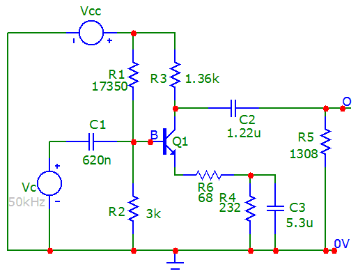

I have to design a Common Emitter Amplifier using a 2N2222 NPN transistor and an 18V DC supply.
  • The specifications are as follows:
  • Should be stable for variations in forward current gain, β.
  • The input signal to the amplifier is a 0.2 Vp sinusoidal signal, at a frequency of 50 kHz.
  • The amplifier should have an undistorted, symmetrical output with an 8 Vpp swing.
  • The output should be maintained over a bandwidth of at least 1 kHz – 10 MHz.
  • The quiescent current is to be 6 mA, at a quiescent collector-emitter potential of 8 V
  • Assume the load impedance is much larger than the output impedance of your amplifier.
  • Ensure the power dissipation of the transistor is kept below maximum operating limits.
I designed the circuit to be as follows:
Rc=(Vcc-Vce-Ve)/Ic
Vcc=18V, Vce=8V, Ve=(1/10)Vcc=1.8V, Ic=6mA
Rc=1.36kΩ
Re=Ve/Ic=1.8/6m=300Ω
R2=(1/10)β*Re=1/10*100*300=3kΩ
Vb=(Vcc*R2)/(R1+R2) -- (1)
Vb=Vbe+Ve, Vbe=0.7V, Ve=1.8V
Vb=2.5V
from (1)
R1=R2(Vcc-Vb)/Vb
R1=18.6k
so, R1=18.6kΩ, R2=3kΩ, Rc=1.36kΩ, Re=300Ω
Is this correct?I think I have to add an un-bypassed resistor to the emittor side.
Also how do I find the values for R5, and the 3 capacitors.
Thank you for the help

All is right up until this last line. This equation is a bit too rough and ready for my liking. (Though maybe your lecturer is okay with it.)
What that equation says is that the current through R2 is equal to the current through R1. This, in effect, ignores the current into the base of Q1, the base current here equalling 6/β mA.
A more precise approach is to say the current through R2 is equal to the current through R1 minus that into the base of Q1.
VB/R2 = (VCC - VB)/R1 – 0.006/β
If you solve this for R1 you'll get a value roughly 10% different from what you calculated by ignoring the base current. The Q point using this more precise approach will be closer to what you initially aimed for (viz., 6mA and 8V).

That's R5 you are calculating, is it? R5 influences DC conditions iff it is directly connected to the collector. If capacitive coupling is used, then R5 is isolated at DC and has no effect on bias conditions.
The reason I'm highlighting AC gain and the small signal equivalent circuit, is that you are aiming for an AC gain of x20. Unless you apply the small signal analysis, you have no idea whether this amplifier will be able to meet that figure; you have no idea what the AC gain will be.

What you did for R5 is not valid for anything. You have a mixture of both DC and AC parameters.
I'd say you probably are not required to assign a value to R5; that's how I'd interpret this clause: "Assume the load impedance is much larger than the output impedance of your amplifier."
If you intend capacitors to have negligible AC impedance, then over the frequency range of interest you choose XC « RT where RT is the Thevenin resistance seen from the capacitor terminals. A simpler but less rigorous way would be to choose XC « R where R is the lowest of the parallel resistances in series with C.
Is that waveform the "sinewave" output? Doesn't look too healthy. That's probably because the circuit has a gain which is much greater than is needed. Can you reduce the input amplitude until the output looks sinusoidal, and determine the gain at that point?
For a sinewave input, a plot of collector voltage will be more informative.

Add an unbypassed resistor to the emitter? but how does that work thenAre the calculations that I did for R1, R2, RC, RE all correct?
Without C3 the ac gain is roughly - Rc/Re = 1360/300 = 4 which it too low.
With C3 the gain is boosted enormously because it reduces the impedance at the emitter to near zero... Rc/0 = ∞
So what you can do is choose Re to suit the DC bias conditions then use a capacitor C3 to bypass "part" of the emitter resistor. To do that split Re into two resistors in series.
Read all of this page (eg scroll down)...
http://hyperphysics.phy-astr.gsu.edu/hbase/electronic/npncegain.html
EDIT: That page shows how the gain depends on on rE the internal emmiter resistor but the same principle applies.
See this circuit..
http://www.ecircuitcenter.com/Circuits/trce/Image02.gif
Note how RE has been split into two and only the lower half is bypassed. This allows RE to be different for AC vs DC.
ok so rE=1360/20=68
then RE=300-68=232
This gives a nice sinusoidal symmetrical output, however it is only 3.6V peak to peak.
that is only a gain of about 9

That looks promising. It is not clear to me whether you are expected to calculate the component values to bring the gain back to -20, or whether you can experimentally determine it. (It is probably a good habit to be keeping the negative sign in front of the gain; this is after all an inverting amplifier, and there may be a ½ mark reserved for that detail in some future exam. :smile:)
You can adjust the gain by inserting a variable resistor in series with C3, say 500 Ohms, and reducing that resistor until the gain becomes -20. I'm not confident that you are going to find gain is constant over a full 10MHz bandwidth, but we'll see. Re-compute the value* for C3 when done.
You can see for yourself whether you have them right by looking at the transistor voltages and currents on your simulated circuit. If the parameters are what you designed for, then you must have got it right! :wink:
I increased RL to 13.08K and now it's a lot closer to 4Vp.
But I am a little confused. Shouldn't each value be able to be calculated in order to reach the requirement of an 8V peak-to-peak output. In the end the only real assumption was the value of Rload which I just made really large.
I haven't finished finding the values of the capacitors yet though. But if I don't come to exactly 8Vpp symmetrical output then I would have had to gone wrong somewhere. (and just adding a resistor and experimentally finding a value that works is wrong)
And what is the formula for finding the capacitor values?

and http://hyperphysics.phy-astr.gsu.edu/hbase/electronic/npncecoup.html
to find the values for C1,C2,C3 to be: 2.06uF for the bypass cap. 0.22uF for C1 and 16nF for C2
how does that sound?
:confused: How did it get to be too small? It is supposed to have been » R3 all along.
Yes, and that is what the design procedure achieves (with most of the parameters given to you in the problem specifications).
That can be taken into account, too, when calculating AC gain.
If you need to adjust gain to a precise value, you have no choice but to set the value by experiment. The model is only approximate, and you haven't measured Q1's beta.
Refer to the procedure I outlined earlier. (If in doubt, make then x10 larger.)
You now have to sweep the frequency over the range of interest, to make sure the gain extends over the full specified bandwidth.
