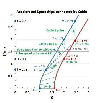

I have often thought about how the one-way speed of light can be measured without having to use synchronized clocks, which tends to be controversial because the clocks are normally synchronized by using one-way light in the first place. Recently, Don Lincoln of Fermi-Lab suggested a method to me. To convince myself, I tested it in a thought experiment, using two clocks and two cables in a frame that is boosted by accelerating it to a new inertial frame. I thought it useful to share it and get other opinions.
First, Don Lincoln's test.
Take two photon detectors. These can be arbitrarily thin - less than a millimeter if necessary. Take the two detectors and place them side by side. From each detector take a cable of a convenient length. Put both of those cables into fast electronics (a modern digital oscilloscope will work just fine).
Fire a light pulse through both detectors. Since these two detectors are adjacent to one another, the transit time from one to the other is of order (1 mm)/(speed of light) = (1 x 10-3 m)/(3 x 108 m/s) = 3 x 10-12 seconds. If sub- 3 picosecond speed is needed, there are ways.
Using your oscilloscope, you can calibrate your cables to establish what "simultaneous" means. In the abstract, the cables can be of identical length. This means that the signals from the two detectors will arrive simultaneously at your oscilloscope.
Now move one detector far away...maybe 1000 feet. Do not disconnect the cables, so you have identical conditions. Fire the light pulse (use a laser) through one detector to hit the other. The signals from the two detectors will transit the cables and hit your oscilloscope at a single spatial point. Since you have already established that the transit time in the cables of both detectors are identical, the only difference between the signal arrival time at your detector is the transit time of light from one to the other. If you have measured the distance exactly, you can then determine the speed of light by distance over time.
I expanded Don's test as follows:
Consider two spaceships connected by a taut cable of 600 units long. Add Don’s second identical cable, folded back and strapped at the half-distance point (for ease of presentation) so that the setup becomes equivalent to his scenario, with the cables calibrated for identical transmission times. Accelerate the whole ‘lab’ lengthwise to 0.6c in such a way that the cables do not stretch (Born-rigidity) and let it coast again.
I used the Rindler coordinates equation [itex]t = \sqrt{x^2-\sigma^2}[/itex], where [itex]\sigma[/itex] is the distance of the start of the curve from the origin (1 and 1.6 units respectively). The origin coincides with the common light cone of Rindler observers with constant proper acceleration ([itex]a[/itex]), where [itex]a =1 / \sigma[/itex]. The other relevant equations are: [itex]\tau = \sigma[/itex]asinh(a t) and v/c = tanh(a [itex]\tau[/itex]).
The spacetime diagram is a tad busy, but gives an overview of all the values calculated for the acceleration phase and the later cruise phase.
Click on the thumbnail below if you do not see the diagram.
For simplicity, use a cable with a signal speed of exactly 0.6c, so that a signal takes exactly one time unit to travel the length of the cable. After the acceleration, the speed of the pulse relative to the original reference frame is [itex](0.6\pm0.6)/(1+0.36)[/itex]c, i.e. 0.882c in the forward direction and zero in the return direction.
In the reference frame the acceleration lasts for t=0.75 units for the blue ship and t=1.2 units for the front ship. The corresponding ship proper times are [itex]\tau_{blue}[/itex]=0.69 and [itex]\tau_{red}[/itex]=1.11 units. The latter clock must be set back by 0.42 units to [itex]\tau'_{green}[/itex]=0.69 units in order to be synchronized with blue again.
The pulse in cable 1 is transmitted simultaneously with the laser pulse and arrives back at the oscilloscope at [itex]\tau_{blue}[/itex]=1.69, while the cable 2 pulse arrives at [itex]\tau_{blue}[/itex]=2.29. This gives a time delay of 0.6 units, which is the travel time of the laser pulse. Since we expect the proper length of the cable to remain the same before and after acceleration, this seems to indicate that it is a true clock-sync-independent measurement of the one-way speed of light in an inertial frame. If correct, this also means that calibrated cables can be used to synchronize distant clocks without slow transport involved.

You should read the wikipedia article on the one-way speed of light. You will see that you have misunderstood what Don was telling you or else he has fooled himself and you. You cannot measure the one-way speed of light, period. All attempts, no matter how complicated or subtle, either are measuring the two-way speed of light or are in fact using the equivalent of synchronized clocks.
You and/or Don have made the faulty assumption that the propagation of an electrical signal down a cable is a constant no matter the orientation of the cable. Suppose that in his setup, you start with the two 1000-foot cables stretched out 500 feet away and back. You are assuming that the time it takes for the signals to get 500 feet away is identical to the time it takes for the signals to get back so that when you stretch out one of the cables the full length it will take the same time to go one-way as it did to go both ways for half the distance. Can you see that this is flawed?
I think you misinterpret. The equal time for equal distance (both ways) in the 'test' is measured in the frame of the moving medium, not the reference frame. I fail to see any flaw in that.
You need the signal speed in the cable to be the same both ways. This is similar to moving objects (or sending light) between the spaceships.

Don Lincoln's version and OP Jorrie's version are interestingly different, and OP's mistake may be in not appreciating this difference.
In the original form, everything is being done in the lab frame, and the calibration process IS a clock synchronization process - the cables are clocks (easily synchronized clocks, but impractical for general use because they only tick twice so can only make a single measurement). The only possibly questionable assumption is the assumption that the signal propagation time won't depend on whether the cable is laid straight or coiled; that assumption can be verified experimentally.
This synchronization process falls apart completely as soon as the cable is set in motion, as in OP's spaceship version. So, although I see nothing wrong with Don Lincoln's one-way measurement, it's still a synchronized-clock measurement; and OP's spaceship variant does not provide a counterexample to the need for two-way measurements.
It cannot, unless you use some other method to sync clocks (like light... but then your sync relies on the one-way-speed of light again).

As Nugatory said in post #6, the cables act as a clock that ticks only twice--good for a single measurement. They are not producing a continual stream of ticks which are being counted which is what happens in a real clock. If they did that, they would go out of sync just like your real clocks, meaning the values of the counters will be different after you accelerate them and bring them together.

OK, I understand, but this seems to imply that cables as 'two tick clocks' establish Einstein's simultaneity in inertial frames independently from clocks in the conventional sense.
Granted, in order to synchronize conventional ticking clocks by means of the cables, we need parameters of the cables that depend on c, like length and propagation speed. I guess that this is where the "hidden two-way speed of light" creeps in.
I don't see why you think that using light signals to synchronize clocks is any different than using cables. Don's method is the same as an observer being midway between a light source and a light target. The observer starts a timer when he sees the flash of light at the source and stops it when he sees the target illuminated. I think you can see that he's really measuring how long it takes for the light to traverse from his location to the target and back to him, in other words, he's measuring the round-trip time for half the distance and calling it the one-way time for the full distance.
If the observer was looking through a medium that slowed the propagation of the light for him equally in both directions but the light going from the source to the target was in free space, then I think you can see that all this would do is add some time to both ends of his measurement and it would come out the same. In fact, this would be no different than if he was equidistant from the source and the target but not in line with them, in other words, he, the source and the target form a triangle. It would also be the same as if his reaction time added some time to both ends of his measurement. As long as they were the same, it won't make any difference. All these deviations from the ideal would be like the cables with a propagation at less than c--it won't make any difference to the measurement--as long as the propagations are the same.
So I hope I have convinced you that electrical signals in cables are not inherently worse or different than light in free space.

So the overall setup with two detectors and a single clock still works as a synchronized clock experiment.
This is the sort of statement that helps the discussion going in circles. If I correctly measure a distance and I correctly measure (in the same inertial frame) the one-way time of propagation over that distance, I define that as being a measurement of one-way speed of something. Whether I have used a calibrated ruler and two synchronized clocks, or I have used two calibrated cables and and one clock, I have performed a one-way measurement of speed. If that speed happens to be c, I have good reason to believe that I have measured the one-way speed of light (or of some other massless particle).
You seem to attach more to 'measure one way speed' than me and disqualifies it as such if there is some two-way propagation used anywhere in the test - it appears as if even replacing the two cables with two extremely accurate runners with pieces of paper, simply saying "pulse detected", will not satisfy you, because at least one of them had to run half-way and back.
I have already admitted that there is an assumption on the one-way speed of light in Lincoln's test (the 1983 definition: "The meter is the length of the path traveled by light in vacuum during a time interval of 1/299 792 458 of a second"). This will guarantee the outcome of his measurement to be c in every inertial frame. This may be exactly equivalent to your "two-way" argument, but IMO it's then neither here nor there.
I will rest my case.
There is a reason why distinction between one-way measurement and two-way measurement is made. Maybe instead of trying to argue that your definition is just as good, you should try and find out why that distinction is made. What it is that these definitions tell you about the physics, and why measuring one-way speed of light would have been of interest.
Jorrie, I have asked you about a scenario in which no measurement of distance is involved and no measurement of speed, only a measurement of time by a single timepiece:
An observer is midway between a light source and a light target. The observer starts a timer when he sees the flash of light at the source and stops it when he sees the target illuminated. Do you agree that he's actually measuring how long it takes for the light to traverse from his location to the target and back to him?
