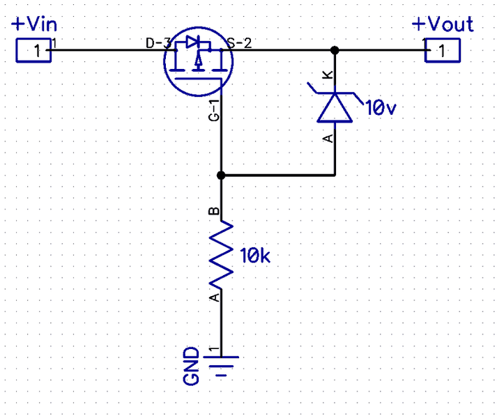

Below is the source of the protection circuit I want to add.
Is it possible to calculate the correct value/capacity for diode/resistor/pmos fet from the description I've given of the power sources and amplifier used?
P-Channel FET
For the ultimate in low voltage drop and high current capability, replacing the PNP transistor with a P-channel MOSFET as shown in this circuit, can’t be beat. Please note that the FET is actually installed in the reverse orientation as it would normally – the drain and source are reversed. This orientation is necessary so that the slight leakage current through the FET’s intrinsic body diode will bias the FET on when the polarity is correct and block current when reversed, thus shutting off the FET. Here is a real nice video tutorial of how the magic works.
If the supply voltage is less than the FETs maximum gate to source voltage (Vgs), you only need the FET, without the diode or resistor. Just connect the gate directly to ground. I have found that most smaller FETs maximum Vgs is 12 volts or less, which can be a problem for 12 volt (or higher) supplies. If after checking your FET’s spec sheet, you find that Vcc could exceed the maximum Vgs, then you must drop the voltage between the gate and the source.
The circuit shown does exactly that by a very clever means. By inserting a zener diode with a voltage less than the maximum Vgs, it limits the voltage to a safe level between the gate and the source. You will need to calculate the resistor value so that it will provide enough current to properly bias the zener diode chosen. The zener diode’s spec sheet will provide the minimum current required to achieve the zener breakdown voltage, and you can then calculate your resistor value from that.

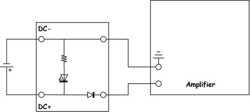

What if I take a less permanent approach? I'm really only using this for the testing phase, it won't be part of the final project since it will be hard plumbed to an internal xformer.
So would this temporary circuit protection circuit work ok?
The concern about diode overheating at 5.0 amps and voltage wasted on the diode wouldn't matter since this module would only be temporary.
Just a little board between the amplifier and the power source with two terminals in and two terminals out. Will this work to protect against temporary reverse polarity? Would the LED light up to indicate the wrong condition?

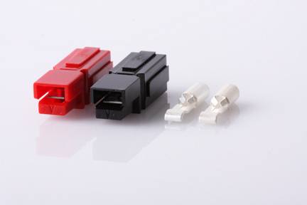

A reversed power diode and a fuse would probably suit you. (Or lots of red and black paint on all your connections and the right coloured wires. lol)

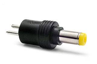

You think the OP would reconsider polarized connectors if they were red and black? :biggrin:
Screw it. This turned out to work perfectly as a temporary "bench-testing" failsafe on a separate little board. Correct polarity... all's good. Reverse polarity... led warning and nothing touches the board (amplifier).
Once I get everything sorted out and tested on the bench and have decided on connections, power supplies, physical layouts, etc... then the board is no longer necessary and I just hardwire. Set the little reverse polarity protection module aside for the next project.

ahhhh the awesome Anderson Powepole connectors. They are used extensively in my radio work and for general use around the workshop
"Best thing since sliced bread" ;)

The notes below the diagram in your first post completely describe how and why the circuit works.
I don't think there is anything about circuit values unanswered.
If you wanted help with picking a Mosfet, which is not calculating values,
here's IR's selector guide
http://www.irf.com/product-info/hexfet/
clicking "P channel" takes me here
https://ec.irf.com/v6/en/US/adirect/ir?cmd=eneNavigation&N=0+4294841671
clicking on IRF9520N , the only one with TO220 because that's a handy package for breadboarding, takes me here
http://ec.irf.com/v6/en/US/adirect/ir?cmd=catSearchFrame&domSendTo=byID&domProductQueryName=IRF9520N
and the top one is only one still available.
Clicking its "datasheet" link takes me here
http://www.irf.com/product-info/datasheets/data/irf9520npbf.pdf
and we see that it has adequate voltage and current capability for the supplies you mentioned.
But its Vgs is only twenty volts which your supply can exceed.
So you'll need to include the zener and resistor as described.
