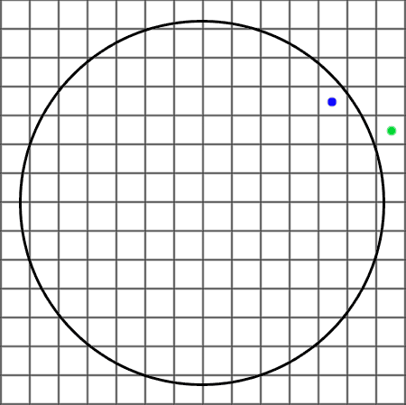

I have a grid and want to determine whether a point lies within (our outside of) a circle.
The grid cells simply have integer coordinates, e.g. x = 5, y = 7. The circle's radius is known, and also an integer value.
I wrote a program that can place points in a (quantized) circle using sin/cos, but I can't seem to wrap my head around how to check whether a grid cell lies within a circle of a given radius. Maybe someone can guide me into the right direction. Thanks.

What is your definition of "within"? Surely that blue square in your picture has a part outside the circle.
If you think of the border being derived from the sin/cos values describing the circle, rounded to the nearest integer; A blocky ring if you will.
It doesn't have to be accurate to the single cell if there's some ambiguity about that. X and Y coordinates and 2 states per cell (on/off) is all that's being processed.
Do you know the x and y coordinates of the center of the circle, the x and y coordinates of your point and the radius of the circle? If so, compute the distance from the point to the center of the circle and compare that to the radius.
Naively, that computation requires evaluating a square root. Can you think of a way to avoid that?
Hint: The square root function is strictly monotone increasing.
That's the help I needed. I'll think about your hint on whether/how sqrt can be avoided in this scenario. I'm not solid in math as is evident I think :shy:
