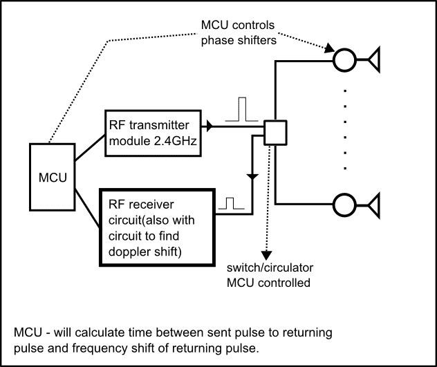

Hi, I am interested in building a very primitive phased array radar for short ranges(1m to 100m).
I thought it's possible to use a simple 2.4GHz RF ASK transmitter, and by just sending a single '1' bit I could generate a pulse and then use a simple RF receiver for that frequency and analyze the time it took the pulse to return to find range and the frequency shift(doppler) to find the velocity of the object I am tracking.
My problems are:
1)I want this to be as cheap as possible(the RF transmitters/receivers are cheap). This way I get a very simple way to generate a 2.4GHz pulse without building a whole circuit with oscillators etc... but the problem is that I need to send a very small pulse to make this work for such a short range, in the order of nano-seconds.
2)Phase shifters are expensive, although I think I can make variable phase shifter with an all-pass filter.
3)I have little knowledge of antennas(I think a dipole will fit my needs).
and If I am correct, in phased array I need to use the same antenna for RX and TX so I also need some RF switch or Circulator to isolate my RX circuit from the TX circuit so I won't fry it.
4)I need to use minimal amount of array elements to lower cost but still get a decent resolution(like detecting a 20cm(diameter) object.
5)I want to find both range and velocity of an object so I can track it as long as it is in range.
I know all these requirement are insane and if I do make this radar it's going to be nothing like I expect, so if you think this is impossible please stop me before I waste my time :).
But if you have solutions for my problems I would be glad to hear.
Basic diagram of project:
you will need a very high prf to do short distances.
i would say over 30Khz
Do you mean pulse repetition frequency when you say PRF?
well the 2.4GHz module has a 2MBPS speed so 30KHz PRF is possible but others problems appear, I need to switch the antenna array between transmit and receive quickly enough to receive the echo of an object from such a close range.
Any basic guidelines on short range phased array from an expert in the field :) ?
You have a transmit frequency which you have established is 2.4 GHz. The prf is separate to the transmit frequency. The prf is how many times you pulse the 2.4 ghz so if your prf is 30Khz that would be pulsing the 2.4 Ghz 30,000 times a second.
2.4 is way to high
i would say 80Mhz with a prf of 30Khz
If you want an interesting project, on which you could learn an awful lot, then go ahead. Otoh, if you want Radar then you may be better to buy a unit for a few hundred quid. There are a lot of non-DIY parts needed, each of which would cost more to buy individually (it's a bit like trying to build a £10k car from available spare parts - it could cost you ten times that much.)
Radar needs a high power transmitter (MWs peak) to give any chance of a significant reflection from a target. That means you need to protect the receiver from the transmitted pulse (proprietary switch I think). The pulse needs to be very short (20cm corresponds to about 1ns) so you would need a magnetron ( which everyone uses for simple radar, afaik)
PRF is not a problem. It's a problem for long distances, when there can be confusion about which pulse you are looking at. You could send pulses once and hour if you wanted to. More frequent just means you improve your signal to noise ratio.
If you use a low frequency (like the suggested "80MHz") the echo from a 20cm target would be far too weak..
What's wrong with a rotating / reciprocating antenna? Phased array is another can of worms for you to tackle. If you need help from an "expert" it means that it will probably be too hard for you. Hardware would cost a lot at 2.4GHz, I think. What angular resolution do you need?
If the target you are tracking could have a transponder on board, life could be a lot easier.
Perhaps giving us a clue about the application details / required spec would help.
A true phased array is going to be difficult; maybe a simple time of arrival system with two antennas would be simpler. Also if the target is biologic the return signal from a target 20 cm is going to be very low as the absorption will be high. Metal would be less of a problem at 2.4 GHz. Do the path loss calculations to see what kind of signal will return for our target. Using a simple UWB chirp and a simple, fast detector should work if you keep your pulse width under 1 ns. CW-FM might work for you but detecting the Doppler down in the noise is always a problem. See patent US 7551703 to understand how to achieve sub mm resolution with an uwb system you can build for under 50$US. It is a very clever design but the devil is in the details to hit .1 inches at 300 feet.
For somebody very skilled and experienced this is a 500 man hour problem. That looks to be a real commitment.

Thanks for all your replies, I am focusing the phased array idea because it's something that's not been done so much before and I can explore different ways to do it and not just copy someone design because it's not as interesting.
techtribes, I choose 2.4ghz because it is available and phased array radars I know use 10GHz or even more. It's a relatively high frequency for these simple RF modules, so I'll get more resolution than a 434MHz RF receiver which is also widely available(higher frequency has smaller wavelength - can't detect and object that is smaller than your wavelength).
Bobbywhy, I already read all these articles(although not thoroughly)and when I mean a 'cheap' radar I meant cheaper than MIT's radar. That radar is really cool but they don't specify any electronics about it and I am not in USA to take that course...
I want to use circuits I make or simple circuits you can buy and connect them so they perform a new function and maybe use new approaches to old problems instead of just buying ready made components that do a certain function and in the process to learn how it all works.
cram thanks for the patent reference, I took a look but it's complex to add something like this to an already complex system.
I've seen real-world examples and they are way too complex and way to expensive.
Lets start simple, if I have these requirements:
*)It needs to be phased array and not SAR/rotating dish.
*)I want to detect both range and doppler.
*)small amount of elements (about 5-12 elements) in the array.
*)Use a 2.4GHz module something like this(use only to transmit):
nRF24L01 module
Other simple replacements will gladly be accepted
*)use an all-pass filter with a digitally controlled variable resistor for variable phase shift:
example of the circuit
*)range of maximum 30m(minimum 1m) and able to detect 20cm diameter ball(has the same cross section from every angle) - the ball is let's say made of plastic or leather, if too difficult let's say it has metallic surface.
*)can be same antennas transmit or receive or some transmit while others receive(in a way that won't damage the receiver).
I thought about using multiple wi-fi antenna modules like in MIT's project but can't think of a way to change the phase between these modules as I know they work with ASK/FSK/etc and phase has less meaning them and it will be difficult to synchronize phase between these modules to get the "phased array" beam-steering.

If you are looking at using the Doppler effect, you might think about a laser device instead of radar. That would take the complications of GHz transmitters and receivers out of the design problem and let you start by solving the signal processing problems. A device using a low power (legal) laser pointer as a transmitter should work OK at range of a few meters.
Google for "laser doppler vibrometer" to get some ideas.
My understanding is you want to detect the velocity and rough direction of an object using a phased antenna. Doing this will also give you a rough position like a ground to air ILS. Using two antenna will give you x and y space telemetry, Z of course would be the planes altimeter. I still say a low frequency at a high amplitude with a high PRF because there will be interference assuming your using it around buildings and trees. And also if the antenna are close to the radio propagation.
Of course ILS uses two radio frequencies instead of a phased antenna. but the same thing applies as the plane will use two antenna tuned to both frequencies to plot its position. You want to read phase difference in one frequency. Which won’t be that good.
Well my main requirement is that the radar is NOT a rotating dish because of it's scanning speed limitations, so phased array is the way to go...
I have never thought of using waves in the near-visible/visible part of the spectrum and I know IR light is used to detect range but I don't know if it is used to detect doppler and I need it to be agile enough to detect and track a moving object without mechanical steering...
And I plan on using it in a less cluttered space(like and open field) and directed mostly at the sky, let's say to track something like a football(not really going to track footballs...)
Strongly suggest you learn something about a) radar, b) antennas, c) phased arrays, d) microwave electronics and e) digital signal processing before starting this project. Based on your postings, your current state of knowledge is not up to the job in these areas. To give just a single example, your 1 ns pulse requires a 1 GHz bandwidth for all system components (transmitter, antenna, receiver, sampler and processor) making this an extremely challenging and sophisticated system.
