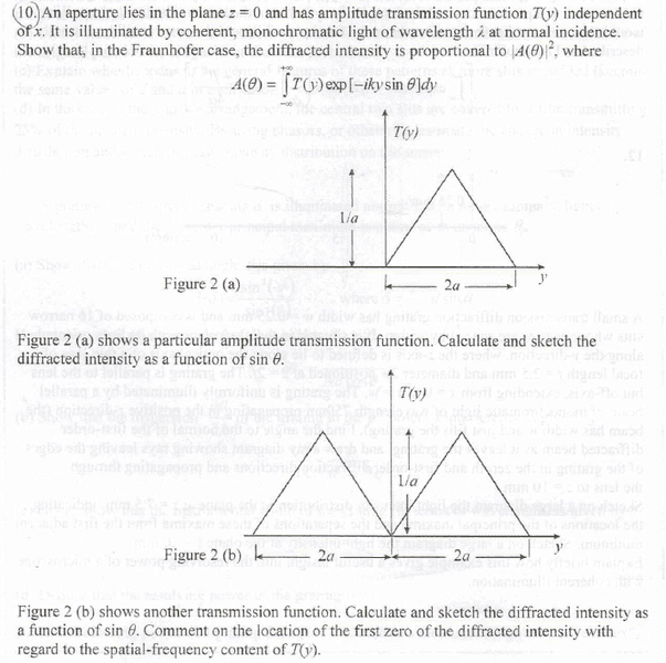

Part (a): Find the intensity as function of ##\theta## and sketch it.
Part (b): Find the intensity as function of ##\theta## and sketch it. Comment on first minima.

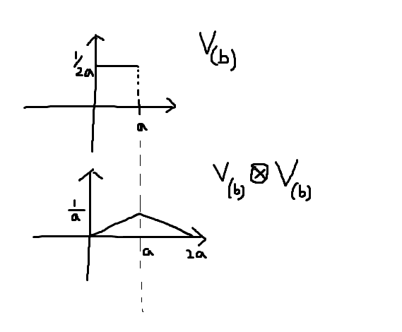

Part(a)
Convolution Method
[tex]V_b = \frac{1}{2a}, 0 \leq y \leq a [/tex]
The convolution ##V_b \otimes V_b ## gives the angular distribution ##V_{b(\beta)}##
Fourier transform of ##V_b##:
[tex]\alpha \int_0^{\infty} \frac{1}{2a} e^{-i\beta y} dy[/tex]
[tex]= \frac{\alpha}{2ai\beta}[e^{-i\beta y}]_a^0 [/tex]
[tex]= \frac{\alpha}{2ai\beta} [1 - e^{-i\beta a}] [/tex]
[tex] = \frac{1}{2} \alpha e^{\frac{-i\beta a}{2}} \frac{sin ( \frac{\beta a}{2})}{\frac{\beta a}{2}}[/tex]
[tex] |A_{\theta}|^2 = \frac {1}{4} \alpha^2 \frac{sin^2(\beta')}{\beta'^2} = I_0 \frac{sin^2(\beta')}{\beta'^2} [/tex]

[tex] A_{\theta} = \alpha \int_{-\infty}^{\infty} T_y e^{-iky sin {\theta}} dy [/tex]
For 0 < y < a:
[tex]T_y = \frac{1}{a^2}[/tex]
For a < y < 2a:
[tex]T_y = -\frac{1}{a^2}y + \frac{2}{a}[/tex]
[tex]A_{\theta} = \alpha \int_0^a \frac{1}{a^2} e^{-ikysin\theta} dy + \alpha \int_a^{2a} \left (-\frac{1}{a^2}y + \frac{2}{a}\right )e^{-ikysin\theta} dy[/tex]

Part(b)
I'm definitely going with the convolution method with this one.
Let ##V_c = \frac{1}{2a}## for -2a < y < a and 0 < y < a.
Fourier transform of ##V_c##=
[tex]\alpha \int_{-2a}^a \frac{1}{2a} e^{-i\beta y} dy + \alpha \int_0^a \frac{1}{2a} e^{-i\beta y} dy [/tex]
Second integral is simply ## \frac{1}{2} \alpha e^{\frac{-i\beta a}{2}} \frac{sin ( \frac{\beta a}{2})}{\frac{\beta a}{2}}##
First Integral:
[tex]\frac{\alpha}{2a}\int_{-2a}^{a} e^{-i\beta b} dy [/tex]
[tex]= \frac{\alpha}{2a\beta i}[e^{-i\beta y}]_a^{-2a} [/tex]
[tex]= \frac{\alpha}{2a\beta i} e^{\frac{i\beta a}{2}} [e^{\frac{3i\beta a}{2} - e^{\frac{-3i\beta a}{2}}}][/tex]
[tex] = \frac{3}{2} \alpha e^{\frac{i\beta a}{2}} \frac{sin (\frac{3}{2}\beta a)}{\frac{3}{2}\beta a}[/tex]
Adding both integrals and multiplying them with its complex conjugate:
[tex]|A_{\theta}|^2 = \left(\frac{9}{4}\alpha^2\right) \frac{sin^2 (\frac{3}{2}\beta a)}{(\frac{3}{2}\beta a)^2} + \left(\frac{\alpha^2}{4}\right) \frac{sin^2 (\frac{\beta a}{2})}{(\frac{\beta a}{2})^2} + \frac{3}{2} cos (\beta a) \alpha^2 \frac{sin (\frac{3}{2}\beta a)}{(\frac{3}{2}\beta a)} \frac{sin(\frac{\beta a}{2})}{(\frac{\beta a}{2})} [/tex]
First minimum occurs when ##\beta = \pi##, but due to the presence of the cross-term, it is non-zero. Is this explanation right?
