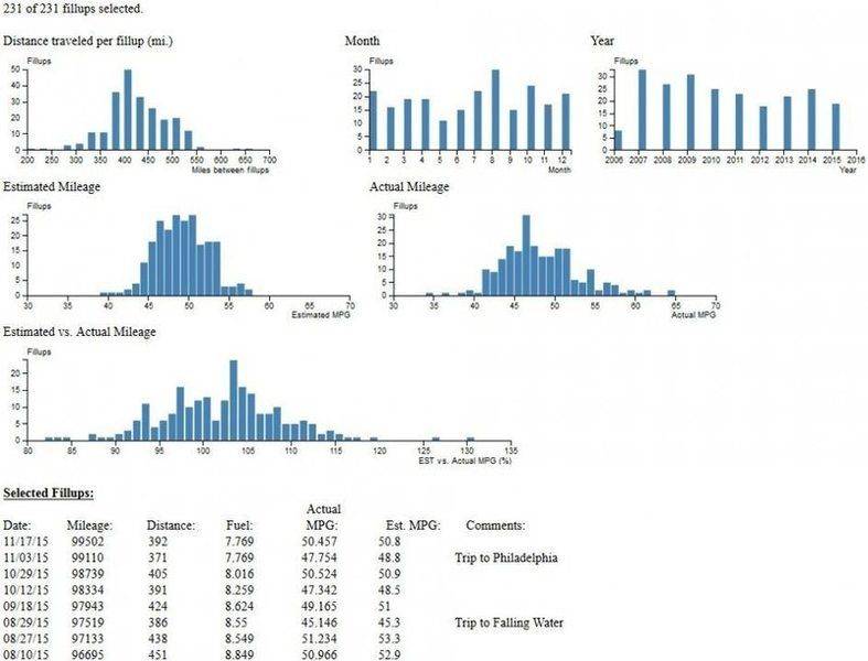

About the data:
Ever since I purchased my car, I have been recording the date, mileage, gallons, estimated MPG and occasional notes every time I fill up with gas. I fill it when it's on the last notch of the gauge (90+ % of the time), have never partially filled the tank and, except for a few rare occasions, have always stopped at whole dollar increments. The dashboard has an estimated MPG that I reset each time as well. If you want to see the code in action, the starting point for my visualizations came from the Crossfilter site.
Here is the starting data without any filters:
As you can see from the data, I generally get around 375 - 500 miles between fillups on a 12 gallon tank and I tend to do slightly more driving in the summer. The estimated MPG that the car reports tends to be in a tighter range than the actual mileage and it has also tended to over estimate it by a few percentage points. Since I haven't normalized the data by month, the data does tend to skew (especially for August).

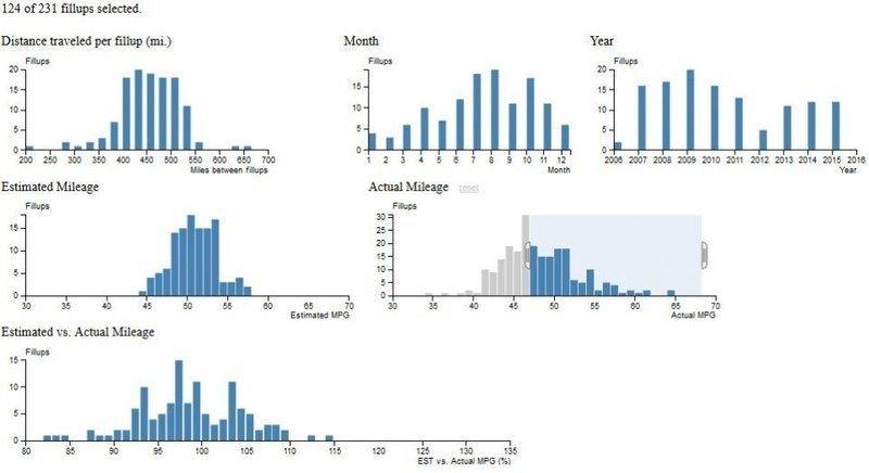

OK, I've got some nice charts that show some minor statistical data but now what? Well, these are cross-filtered charts which means that I can select specific sections of one chart and all of the other charts are automatically updated. Let's take a look at my anecdotal assumption about mileage being better in the summer. To do that, I'm going to select all of the actual mileage data to the right of the peak.
As I expected, the fillups with better actual mileage tend to occur in the warmer months. It also seems that the number of good mileage fillups have been going down in the last few years. Another thing that I notice is that the estimated vs. actual mileage has shifted down. It seems that the car tends to under-estimate the mileage on good MPG results. Hmmm, I wonder if that's true?

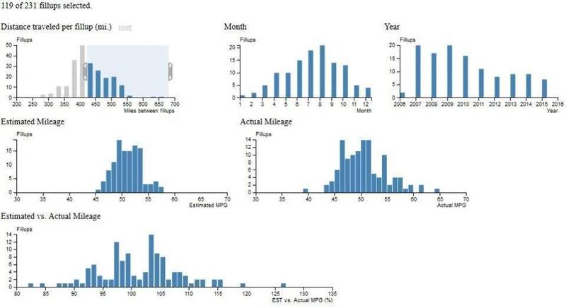

But first, I want to look at the distance traveled chart. By selecting the right side of the bell (425 miles or more), I get a much better bell centered on the summer months.

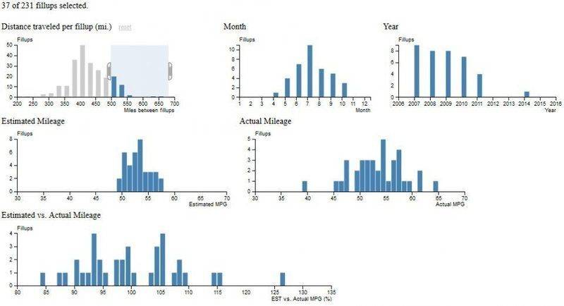

However, I remember that my data isn't normalized and decide to just look at the records where I traveled 500 miles or more. Now I have a more defined bell curve centered on July - half of all of the July fillups resulted in 500+ miles. But then I notice the year chart - I've only had a single 500+ mile tank in the last four years!
I'm not sure what could be the cause of this but it seems clear that the car has been struggling with its MPG over the last few years.

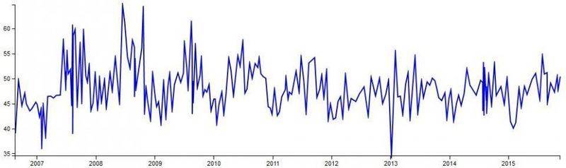

I do know that there are clear variations between tanks because of the up and down swings from the actual MPG plot here. I plan on adding a 2 - 3 tank moving average to try to smooth it out. Still, you can see seasonal variations in the calculated MPG readings.
That is an expected bias from your selection.
Think of the distribution in two dimensions: you tend to keep "good actual mileage, lower expectation" but remove "high expected mileage, lower actual value".
You have gotten more conservative with (not) using the remaining fuel, or distance between gas stations decreased?
Or the car got older and has a lower efficiency now, which is certainly some contribution to the effect.

Thanks for your comments. I haven't done much in the way of statistical analysis so I expected some wrong conclusions on my part. I do think that the car has been getting less effecient though.

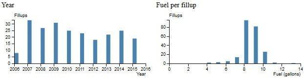

So... Rather than trust my assumptions, I added a fuel chart. Here's the starting chart which shows the vast majority of my fillups are between 8 - 10 gallons.

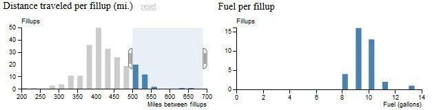

When I select all of the 500+ mile trips, I used between 9 - 11 gallons of fuel.

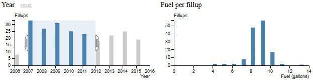

The 2007 - 2012 years had most of the 500+ mile trips so, selecting them gives this result where the fillups are slightly higher than the curve shown in the first graph.

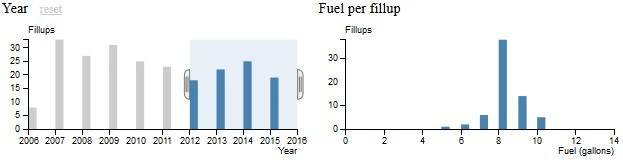

However, when I look at the 2012 - 2015 data, the records show that the fillups have been mostly in the 8 gallon range.
I guess that I've gotten more conservative with not using the remaining fuel after all!
