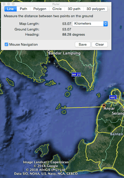

If you've never subscribed to Facebook, now might be the time.
https://www.facebook.com/Oystein.Lund.Andersen
He's a photographer, and only 50 km from the volcano(Anyar, West Java). He took a great picture of it yesterday. (It has a © on the image, which is why I'm not sharing it directly.)
He also posted a video of a drone flight over the volcano on Aug 9th. It has a great shot of how steep the flank of the volcano is. I can imagine it sliding off into the sea.

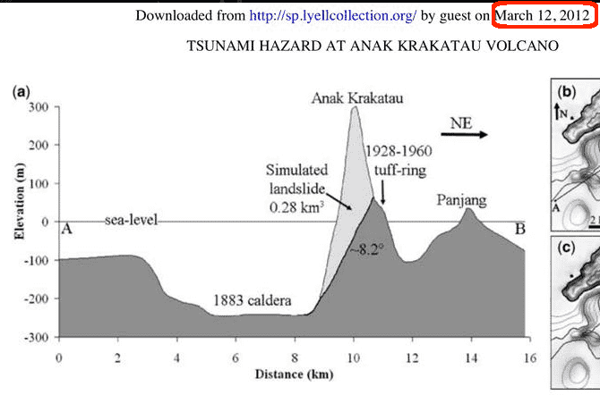

The following image popped up in my Twitter feed this morning:
What most caught my eye, was the date: 6 years ago!
So I tracked down the original paper:
Tsunami hazard related to a flank collapse of Anak Krakatau Volcano, Sunda Strait, Indonesia
T. Giachetti, R. Paris, K. Kelfoun and B. Ontowirjo
Geological Society, London, Special Publications, 361, 79-90, 3 January 2012
Abstract
Numerical modelling of a rapid, partial destabilization of Anak Krakatau Volcano (Indonesia) was performed in order to investigate the tsunami triggered by this event.
...the maximum wave height recorded off Anyer and Merak is around 1.5 m in our simulation...​
According to one news account; “Actually, the tsunami was not really big, only 1 meter (3.3 feet),” said Prasetya, who has studied Krakatoa. [ref]
It looks as though that was a very good simulation.
Likes Klystron, davenn and BillTre

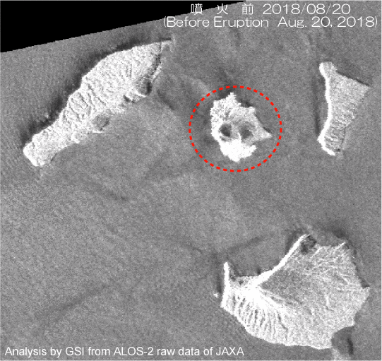

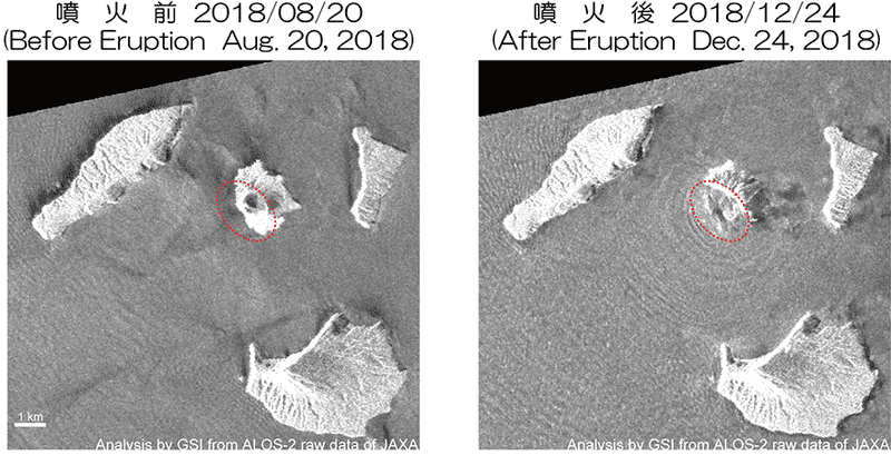

Likes davenn and Ophiolite

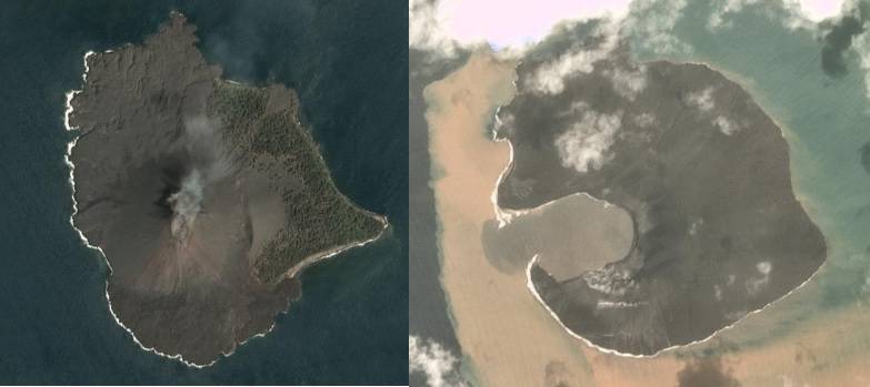

Apart from some surviving 'twiddles' at upper left, you'd doubt it was the same island...
Borg said:
CNN has a clearer set of before and after images in this article - Satellite images show extent of Indonesian volcano's collapse.
I think North is to the top of the images.
I was looking for maps of the damaged areas, and I'm not currently finding a lot of details, but there is this BBC article.
https://www.bbc.com/news/world-asia-46663158
Areas to the NW and SE got hit hard, from what I gather from limited reports. However, it appears in the images Borg posted, that the landslide and cone collapse or explosion was on the W side of the island. I would think that nearby Sertung Island would have provided some protection to the coastlines of Sumatra, and the larger Krakatau Island to the SE would have protected the Java coastline near Pandeglang, but that doesn't seem to be the case. This is puzzling.
