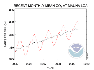

There's another good diagram that shows that emissions are small in magnitude compared with other fluxes over a year, and at the same time are the major driver for change over several decades. This is from the NOAA monitoring station at Mauna Loa.
This is a measurement of atmospheric carbon dioxide. You can see a clear annual cycle, due to seasonal changes in the large natural fluxes in and out of the atmosphere. On top of this, there is a steady trend, most of which is due to fossil fuel emissions. The large fluxes redistribute carbon between ocean and vegetation and atmosphere. The small but cummulative emissions flux adds more carbon into the carbon cycle, without replacement.
So yes, the number you've quoted makes sense, and it is completely consistent with the fact that anthropogenic emissions are the major driver of a changing climate in the present.

OB 50, by extention of the comments by sylas and Ivan, the 3% number is roughly correct but it is also irrelevant. About 100% of the *change* in CO2 *concentration* (i.e., from 280 to 385 ppm) is due to human activities, as can be clearly seen from the isotopic signature of fossil fuel carbon, as well as the fact that carbon content in the oceans and terrestrial biosphere has both increased (if the change in concentration in the atmosphere was natural, you'd expect a decrease in these carbon reservoirs as it would be mined into the atmosphere). It is the concentrations that matter for radiative transfer (and hence warming of the surface-troposphere system), and human activitity is clearly why CO2 is changing today.
This is a fundamentally different question that how anthropogenic CO2 *emissions* compare with natural fluxes. In fact the carbon exchange between the oceans/biosphere and the atmsophere is much higher than the anthropogenic exchange, but the natural fluxes in pre-industrial times were roughly in balance (i.e., what went in also goes out) such that the absolute CO2 concentration in the atmosphere was nearly stable over the whole Holocene.
By analogy, suppose you had a sink with a faucet and drain. The faucet pumped out 30 units of water and the drain got rid of 30 units of water over the same time frame, such that the water level in the sink was roughly stable. Now suppose someone comes in and dumps about 1 unit of water in without changing the efficiency of the drain. Now you have 31 units going in and 30 going out. It is true that "1" is probably small compared to "30" but now the much more important point is that your equilibrium system is now thrown into a state where the water level can only rise, despite the fact that it will take some time to be overpowering. As this imbalance persists over extended periods of time, the water level change will eventually become significant, and probably reach a new equilibrium eventually (say as increased downward pressure makes the drain more efficient) although the water level will stabilize at a higher point in the sink. Right now though we're putting CO2 in much faster than the oceans can possibly keep up with (see some of David Archer's work on the millennial-scale lifetime of our extra impulse of carbon) and therefore concentrations can only rise. The other thing is that natural sinks are probably in significant decline, which makes natural removal processes less efficient and is contributing to the near-exponential rise in CO2 levels.
