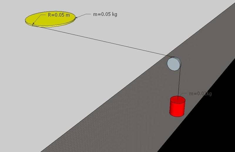

There is a disk with mass 50 grams put on a slippy surface (no friction!). Its radius is 5 cm. Mass of the weight is 20 grams. At the beginning there is no motion. How far does the center of mass of the disk move in 10 seconds? (answer: 91 m) How many turns does the disk in 10 seconds?

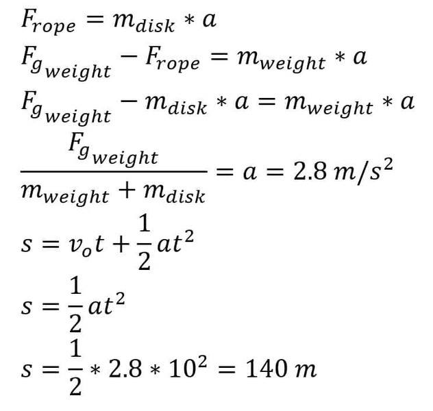

F=ma
F*r = J*alpha
The only force on the disk is the force of the rope if there is no friction. -->
I did not solved the second question as the first answer is wrong. Please help me, correct me.
Is the acceleration of the center of the disk the same as the acceleration of the hanging weight?
Likes srecko97
Yeah, right, they are not. But I do not know how to solve it in other way
acceleration of the disk = force of the rope / mass of the disk ... Is that correct?
Yes. ("Acceleration of the disk" means the acceleration of the center of the disk.)

You will need to relate the acceleration of the hanging weight to the acceleration of the center of the disk and the angular acceleration of the disk.
Likes srecko97
angular acceleration (alpha) = (2 * force_rope )/ (mass * radius)
Likes TSny
yeah,yeah, i think i got it! circimferential acceleration + acceleration of center of mass = acceleration of weight , right?
Ok, thanks, I got the right result! Your hints are very useful! Can you give me your phonenumber? ... just joking! have a nice day, thanks!
