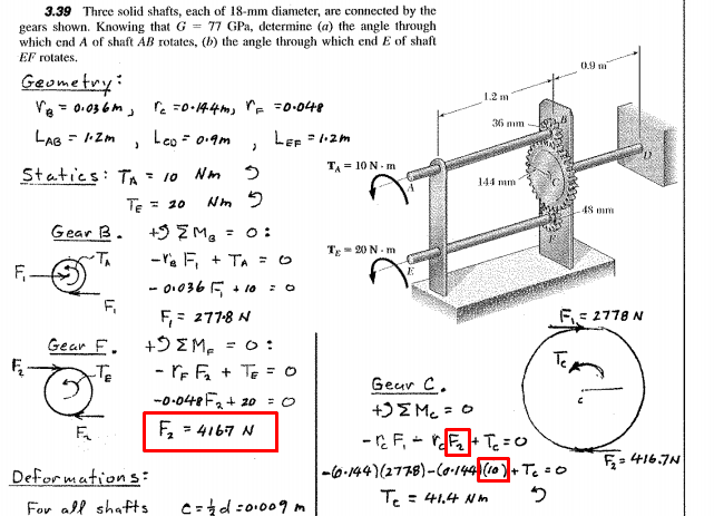

Actually I have two doubs, the first one is Why in the solution of this problem, in the sumatory of moments in C, Force 2=10?? If in the sumatory of moments in F, Force 2 is 416.7 N. Actually I calculate with 416.7 N, and T in C = 100 N. The other doubt is with the sign of the torsor along the axis CD. Because the action-reaction law, the torsor in the axis will enter in the axis, thus it will NEGATIVE, but the solution takes positive!. Why??
It is in the The problem statement, at the picture

You are saying that the book's solution shows F2 = 10N? That seems way off...
And as for the direction of the net torque on the center gear, I think you have labeled the direction incorrectly. The force F2 on the bottom of the gear is larger, so the net torque will be towards the back of the apparatus (clockwise as seen from the front)...
Likes Queren Suriano
