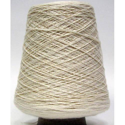

1. It is a simple basic cotton yarn , I don't know what else it is called but i have attached a pic of the yarn. This type of yarns are used for sewing and generally
