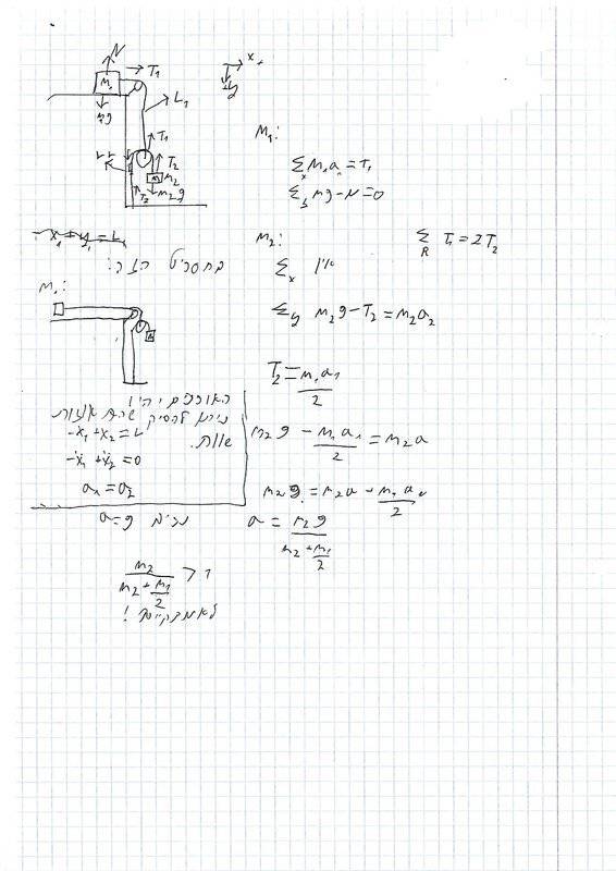

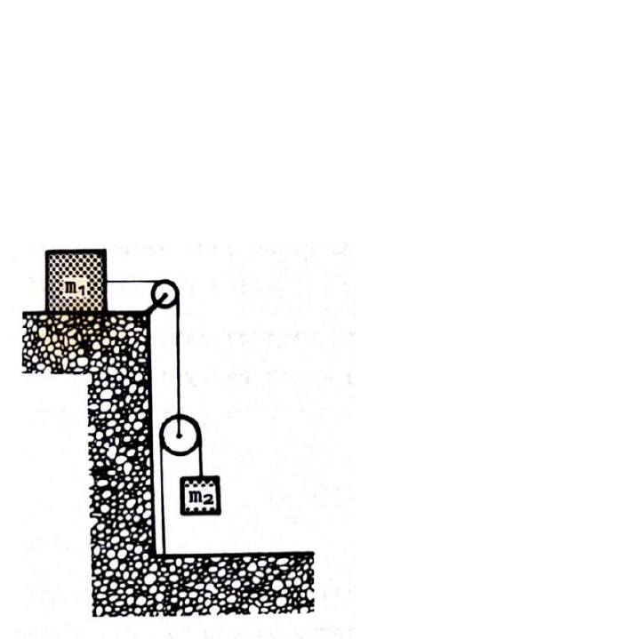

hey there,
I am confusing what is the right answer to this system of mass, I solved it a couple of time and I got different answers. can you help me with that?
I need to find the expression of the acceleration of the 2 masses.
thanks a lot,Adam.

Can you show us your attempt? We can't offer any help or advice without first seeing in detail what you've tried. Thanks.
on the left middle; if the system was stretch all the way. it will be easier to find the length equation, thanks a lot/
I see you somehow got that a1=a2. That is incorrect.
Likes Delta2 and Chestermiller
ok i will try it agian
Consider that the rope attached to M2 is of constant length. That places a constraint on the relationship between a1 and a2.
