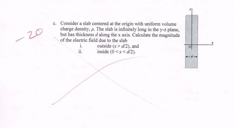

Consider a slab centered at the origin with uniform volume charge density, ρ. The slab is infinitely long in the y-z plane, but has thickness d along the x axis. Calculate the magnitude of the electric field due to the slab
i. outside (x > d/2,) and
ii. inside (0 < x < d/2).
[see attachment for figure]

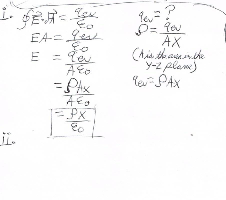

Well, it's electric field, so I'm assuming Gauss' Law is the best way to solve this thing… and… I think that's the only formula you need.
So, yeah, Gauss' Law is the integral of E dot dA equals charge enclosed divided by permittivity of free space… yeah, you know the whole deal… the equation is in the first line of my work which is attached.
The first time I saw this question I had no idea how to do it (as you can see in the figure, I lost a lot of points :s) because I was confused on how to even approach it with area of the slab from all sides being infinity. Right? That's problematic, no?
Today, I just tried the problem again for the first time in a while and I got an answer but I don't know if it's correct. (Well, I got an answer for part i; I haven't done part ii yet, but once I find out how to do part i, I know doing part ii will be real easy. Mathematically, it'll be, like, the same exact thing as part i with just a different value of charge enclosed. But anyway, yeah, the point is, I've only done part i so far.) See attachment for my work; the answer I got was ρ/xϵ0. I'm guessing this isn't correct, cause area canceled out when I was solving for it so it's independent of area… and how could the electric field generated by this thing be independent of its area? That doesn't make any sense… right?
Like, the electric field generated by this infinite slab would have to be different from the electric field generated by a finite slab, right? My answer goes against that notion.
Any help would be appreciated. Thank you!
You have not specified what Gaussian surface you are using.
Likes askcr9
Yeah, sorry, I'm using the Gaussian surface which is exactly the same as the surface in the problem just with a thickness of 2x rather than d.
(and I would use the same exact Gaussian surface for part ii as well; x would have a different domain, though, as the problem itself says)
Then your result for the enclosed charge is not correct.
Also, the area is infinite. You should choose a smaller volume.
Likes askcr9
My enclosed charge is incorrect? Ok… I don't know why…
Oh wait, I think I know the problem. It's because ρ as given in the problem is the charge density for the surface given in the problem. It isn't the charge density of my Gaussian surface.
So Qen = ρAd, right?
So my E would be ρd/ϵ0.
But this is wrong too? It's still independent of area…
Regarding the second thing you said, if I chose a smaller volume, then the A's wouldn't cancel out when solving for E and I would have two different area values… that would be problematic too. I would need to simplify the answer further but I wouldn't be able to with two different area values. Most problematically, I wouldn't be able to express the Gaussian surface area value in terms of what's given in the problem.
I hope my writing is comprehensible!

Ok, I get it, it's dumb for to think it'd be dependent on area. Every other Gauss' law problem I've ever done the answer has been dependent on area… but this is just an exception and the area is infinity so the answer in reality make sense, at least to me.
When I said two different area values I meant an area value for the actual surface (called A here) and an area value for my Gaussian surface which if I made my Gaussian surface have less volume then I wouldn't be able to express this area in terms of what's given in the problem.
The flux is infinity cause the area is infinity. Flux is BAcostheta. So the area being infinity makes the flux infinity as well.
So is ρd/ϵ0 correct? You never said it was wrong so I'm just wondering
Have you studied (or at least been shown) the derivation for the electric field of an infinite sheet of charge?
Likes askcr9
Oh yeah, it's like charge density / 2ϵ0. I had heard the result before, but I had never seen the derivation for it until I looked it up just now. I wasn't thinking about that anyway, I guess it's similar to this question.
In the derivation I saw, they took into account both sides of the infinite sheet of charge, so the total area ended up being 2A and there ends up being a 2 in the denominator. Is that something I would have to do here?

So then, back to part i, when I sum up all the faces on my Gaussian slab, I end up getting a 2 in the denominator of my fraction, so I get ρd/2ϵ0. Is that right or am I still wrong?
(I mean, I'm guessing it's wrong, I think that's what Orodruin was saying in the post above yours. My Gaussian surface is wrong? Am I suppose to be instead using a finite Gaussian surface…?)
askcr9 said:
@gneill
Ok
The 2 in the denominator is okay. Your result looks good.
I believe that what @Orodruin was referring to (and I stand to be corrected) was that you were thinking of Gaussian surfaces that were infinite in extent, but that you should consider ones that are finite instead.
The example of the electric field due to the infinite sheet of charge that was mentioned earlier should give you that hint. Don't try to encompass the entire slab with your Gaussian surface. Instead use a finite region as in the aforementioned example.

The result is not wrong, but your way of arriving at it is as formally you have two infinities on either side of the equation.
As @gneill said, you should choose your Gaussian surface carefully and be careful in comsidering the contributions to the flux through it.

Gaussian surfaces can be of any extent and shape. However, their usefulness in terms of analysis of a given situation depends upon careful consideration.
Pay attention to the derivation of the electric field due to the infinite sheet of charge! Was the Gaussian surface employed of infinite extent? Nope. A carefully defined segment of the sheet was selected and the charge encompassed by that segment was considered. The charge encompassed by the surface was related to the overall charge density.
Clearly the total charge of an infinite sheet of charge would be infinite, right? Infinities are awkward to deal with, so a Gaussian surface that enclosed an infinite charge is not the right approach. Instead, a finite "sample" of the whole is considered with an appropriate Gaussian surface. In the case of the sheet of charge, a finite cylindrical "slice" of the sheet is chosen. That's a good hint as to how to approach this problem. The charge density gives you the net charge within the portion of the surface selected.
The idea can be readily extended to the case of the slab. Choose your Gaussian surface appropriately and use the given charge density to determine the charge within a given Gaussian surface (or volume).
When you look to find the field within the slab, you will need to employ more than one Gaussian surface, as there will be charges "inside" and "outside" your position with respect to the center of the slab.
